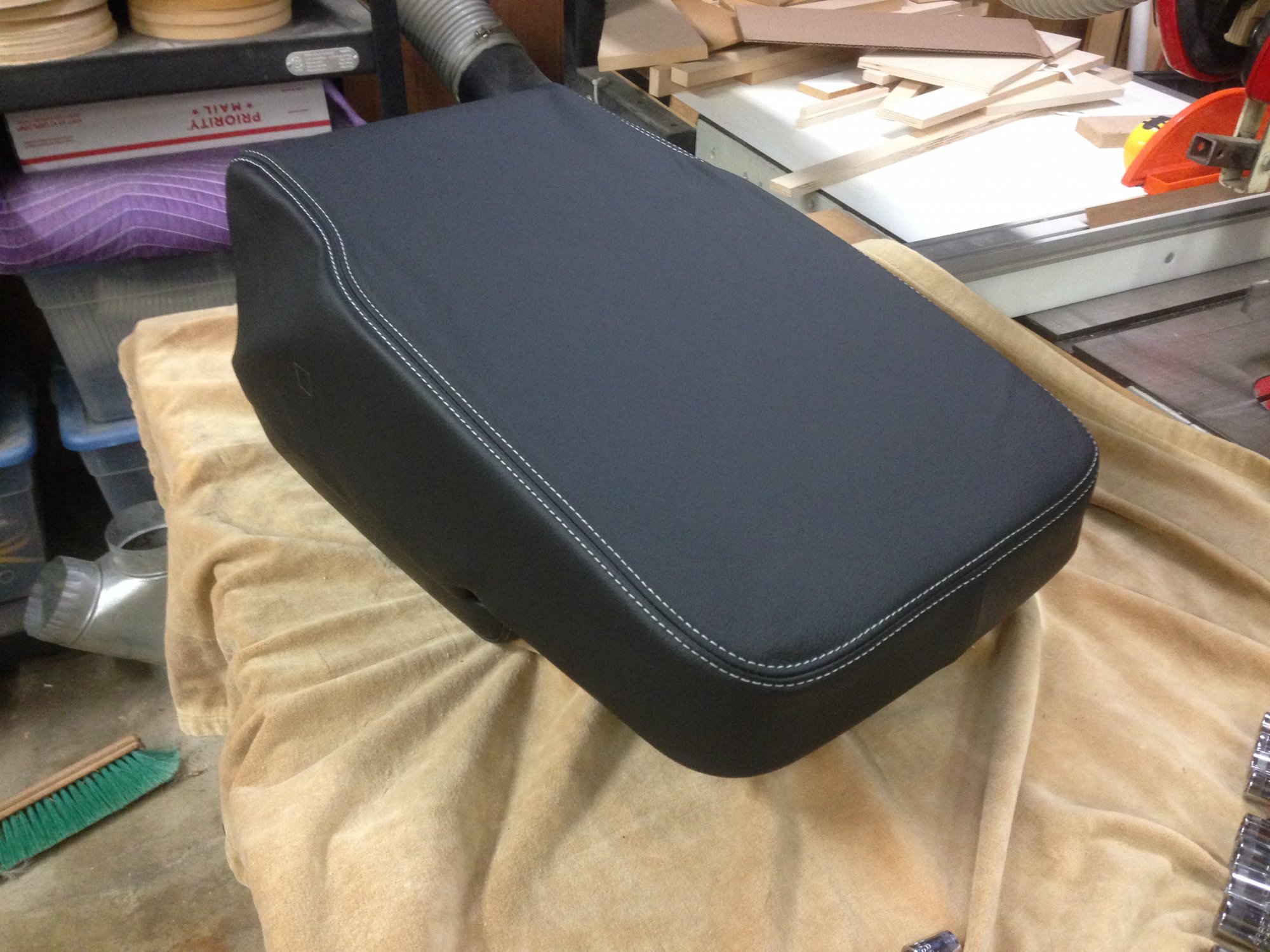

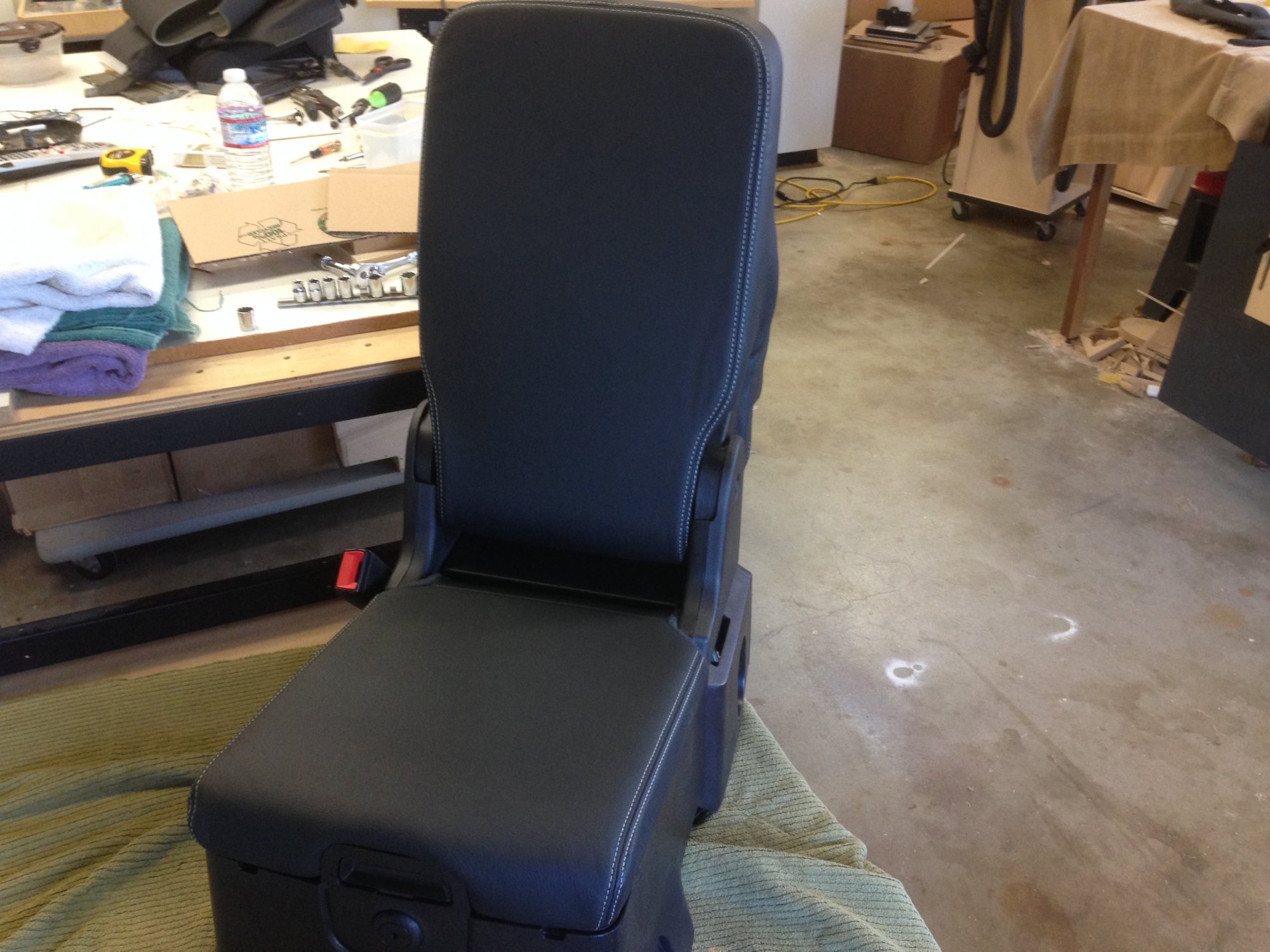

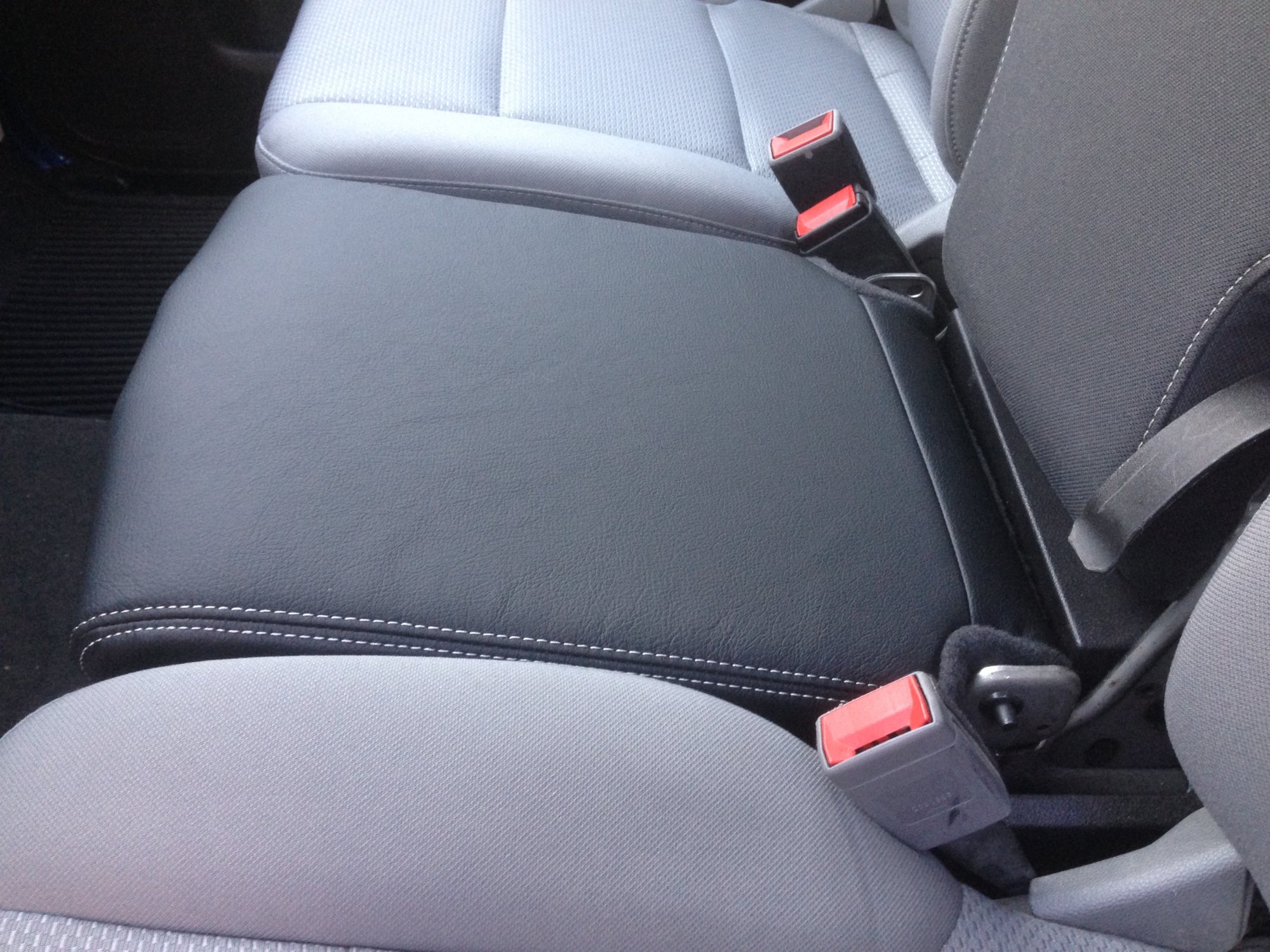

Got started on the jump seat leather upgrade and once I get that done I'll be mounting the amp inside the bottom compartment.
IMG_1509.thumb.JPG.b038c4d400490719d8a63a09aaa0833c.JPGIMG_1508.thumb.JPG.f9b86b561c71b5e2e732ad24ea1fc97d.JPG

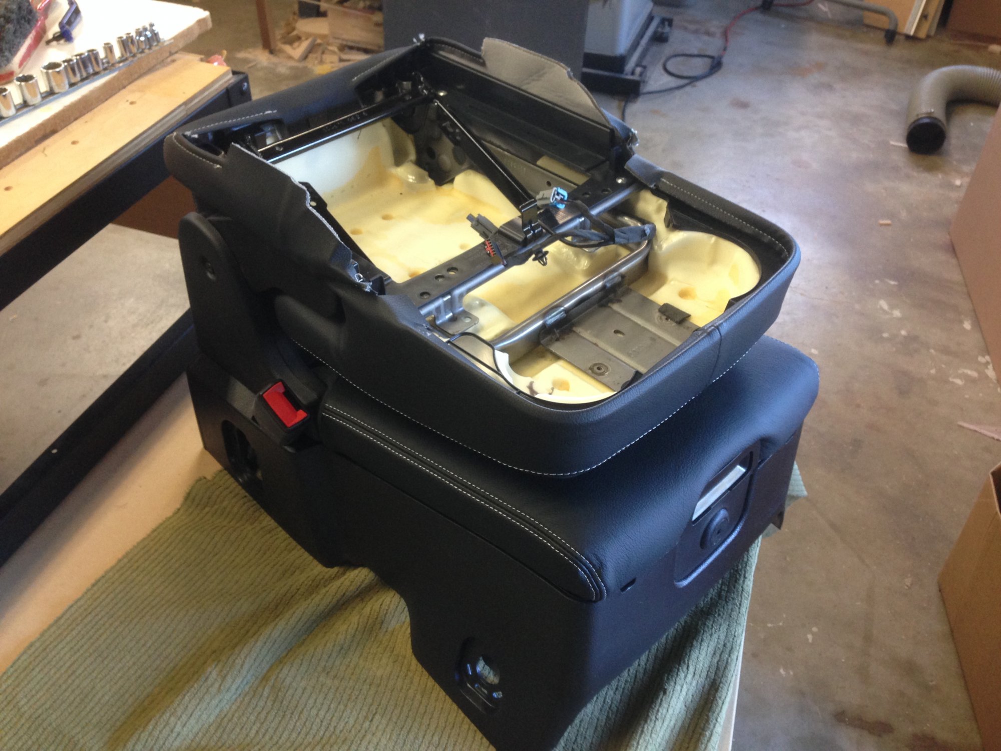

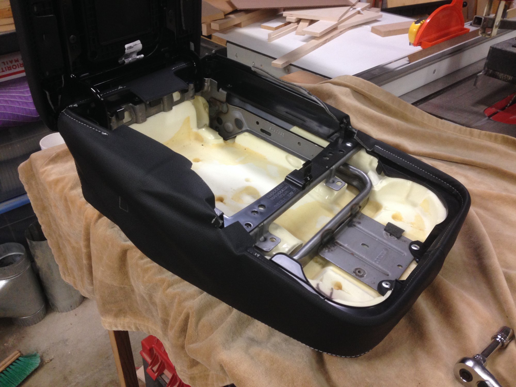

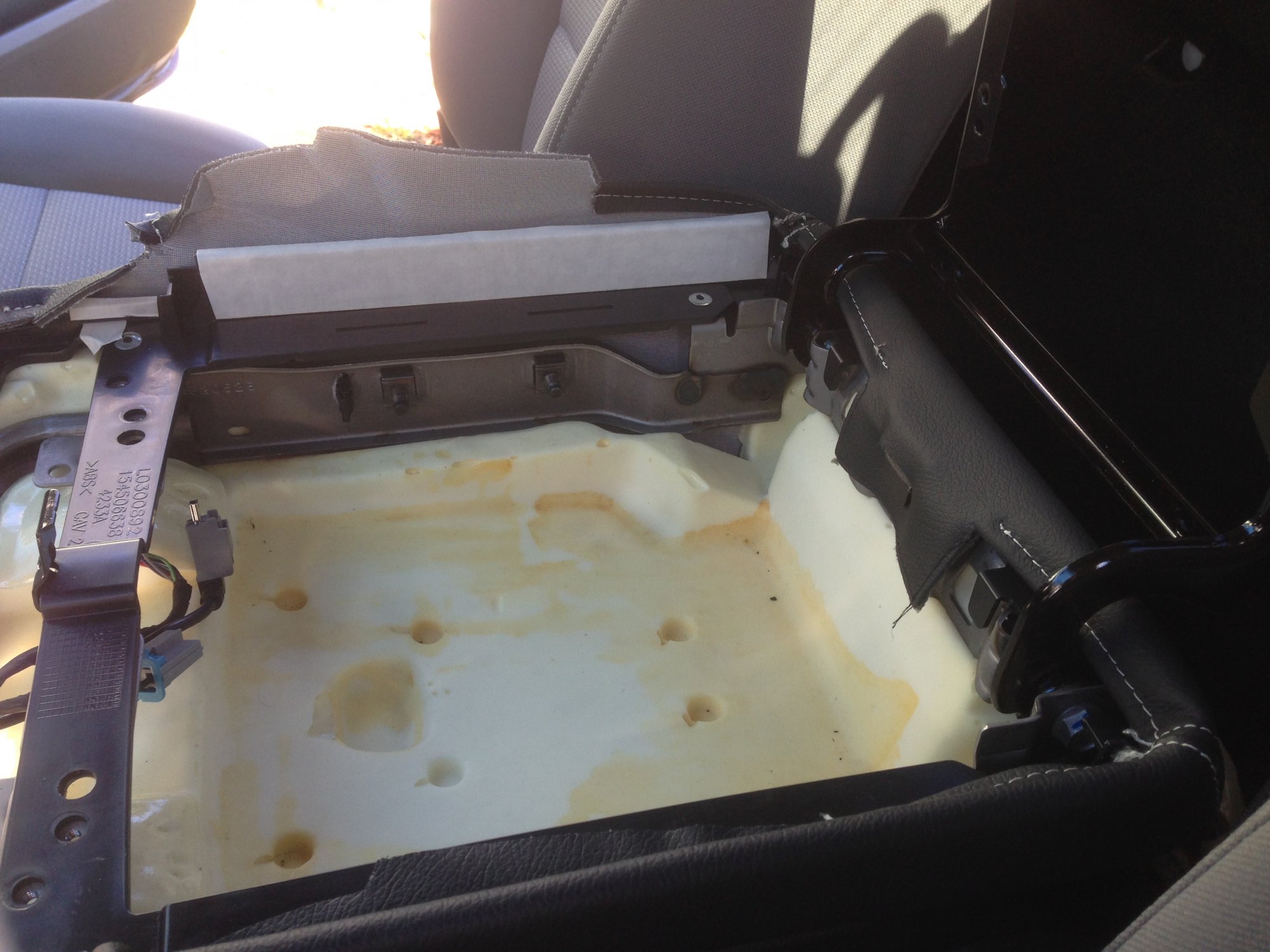

Seatback is a little more challenging (they didn't include original type clips on the inside) so it looks like I'll have to remove the entire unit and improvise a bit.IMG_1512.thumb.JPG.f522c02905fab08014d6b32cfccec624.JPGIMG_1511.thumb.JPG.f877c04f761a5bbf6701b033ae499f84.JPG
I still need to figure out how to secure the material inside on top as I don't think the plastic insert will hold it in place but overall it wasn't  that difficult. IMG_1515.thumb.JPG.0154c975f5c1afbe568450a44e3ad28c.JPGIMG_1514.thumb.JPG.90551879d7c83e240a3a4d660c3f2fe6.JPG
I eIMG_1517.thumb.JPG.8bb361156bde987772e8533f6139d12f.JPGIMG_1523.thumb.JPG.109f628fc97415950daa8fa0e86f43d0.JPGnded up using industrial strength double sided tape to hold the material under the bins in place so we'll see how well that holds up.

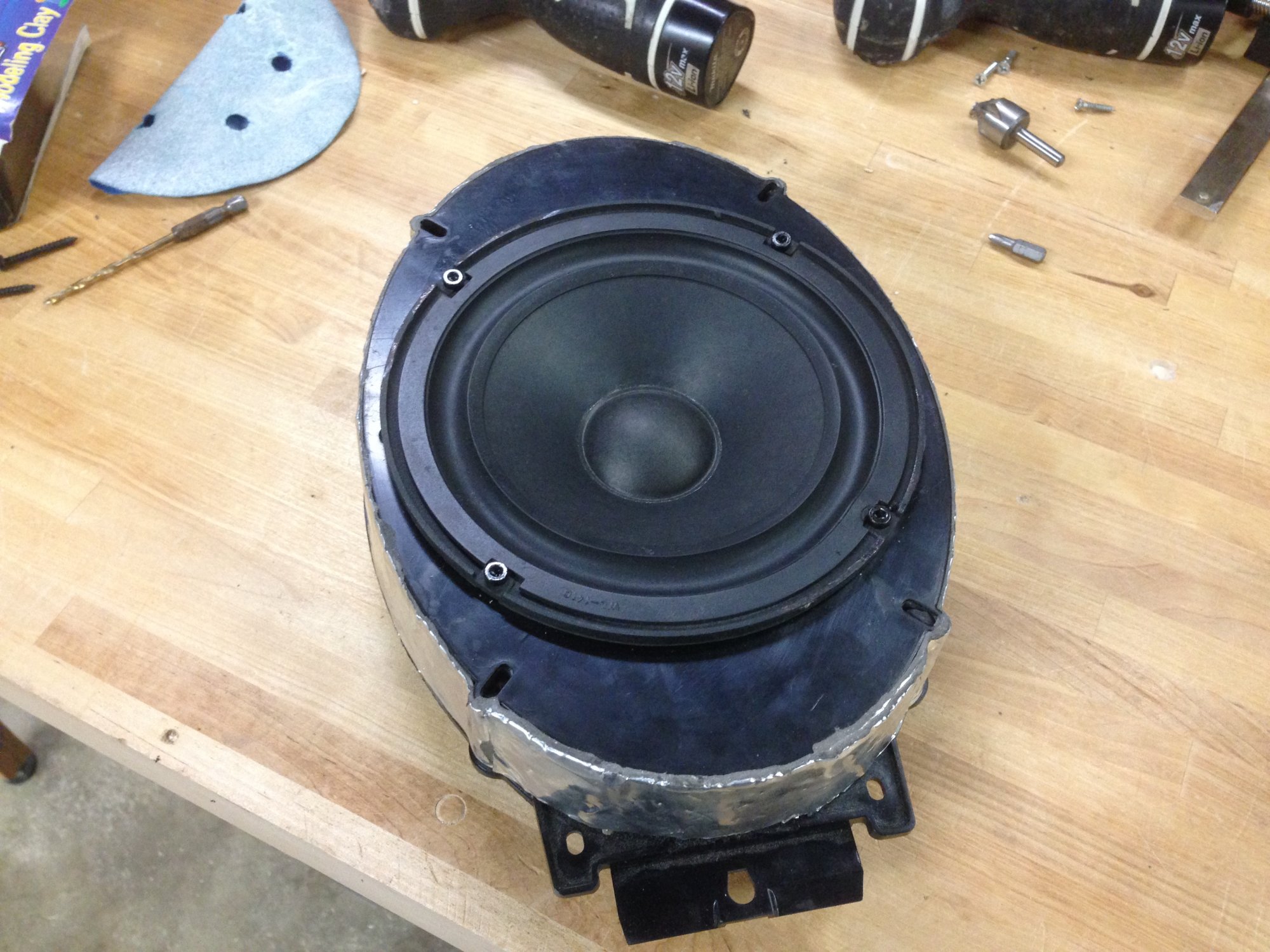

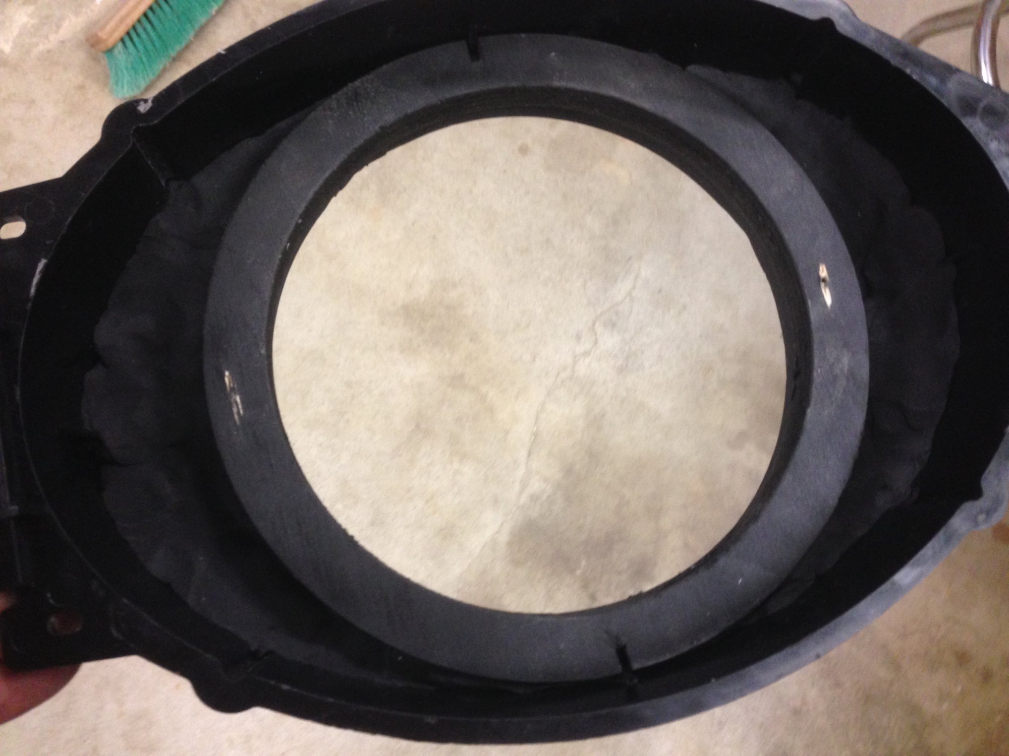

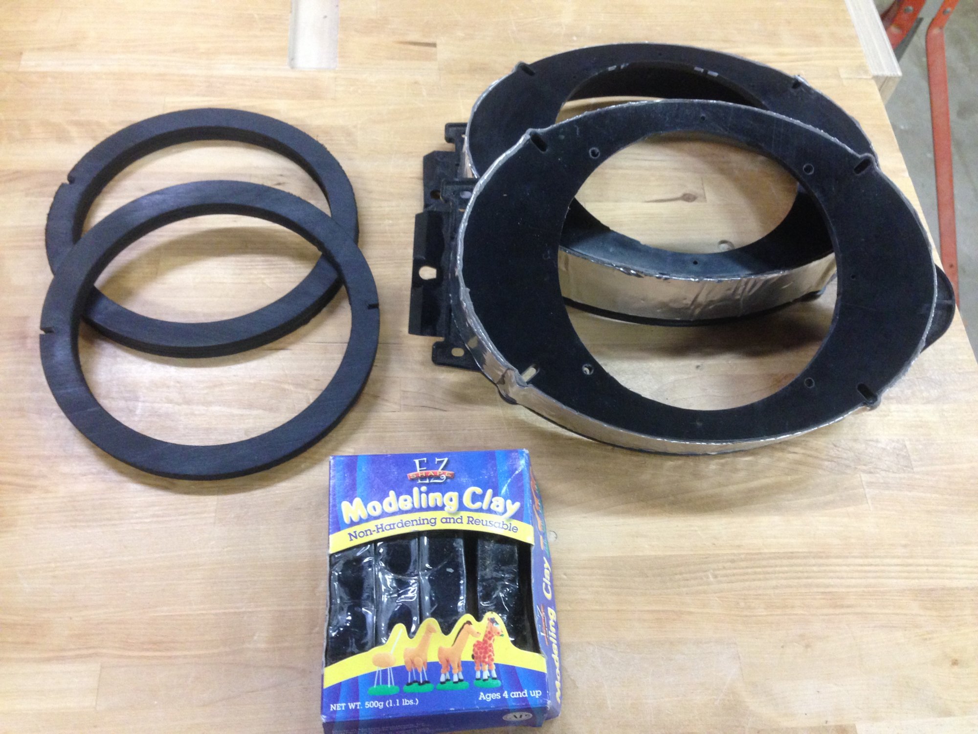

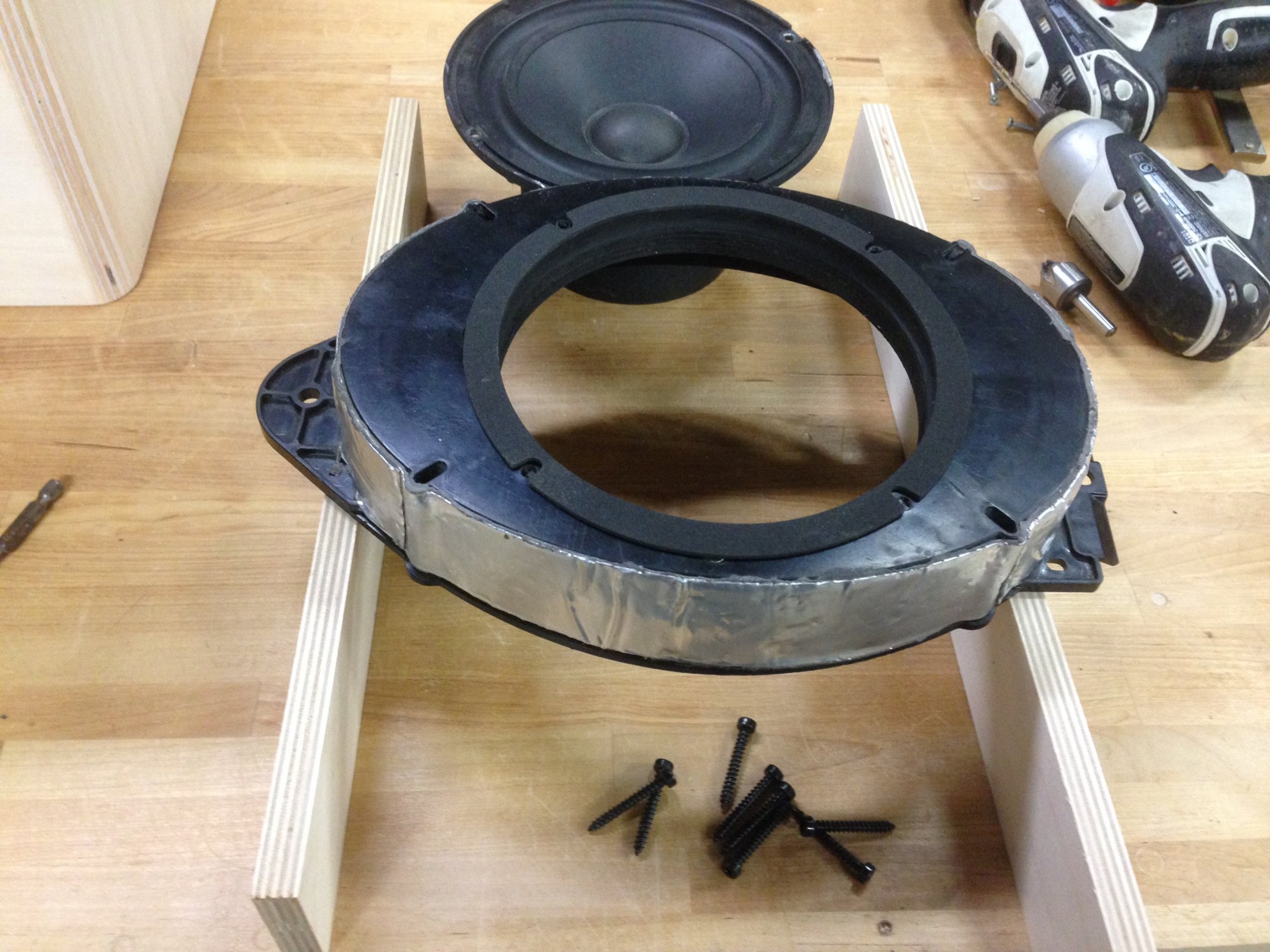

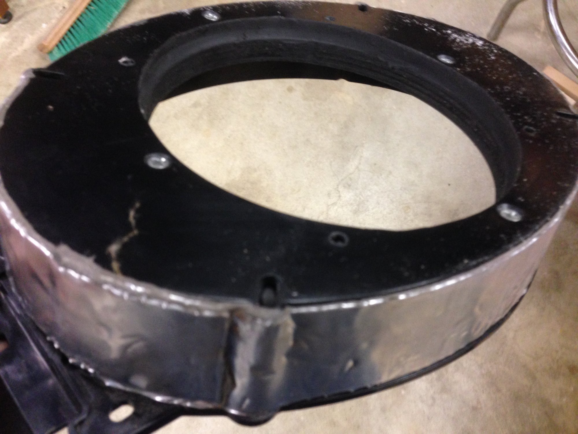

I finally got around to finishing the speaker adapters. The rings are 13mm Baltic Birch sealed with black paint and the outside is wrapped in RaamMat sound deadener. I laid out  a bead of non hardening modeling clay between the rings and plastic, squished them together with clamps, countersunk some holes in the top of the adapters and screwed them together. I then packed around the rings and bottom with more clay making them very stiff and totally non resonant. I will use Raamaudio Ensolite stick on foam for a gasket between the door frame and adapter and foam weatherstripping to seal the adapter to the inside of the door panel. IMG_1612.thumb.JPG.7b179db2357bc1987762fd42322551d6.JPGIMG_1614.thumb.JPG.07af77982ce39f625cf2f0f0597b0821.JPG
