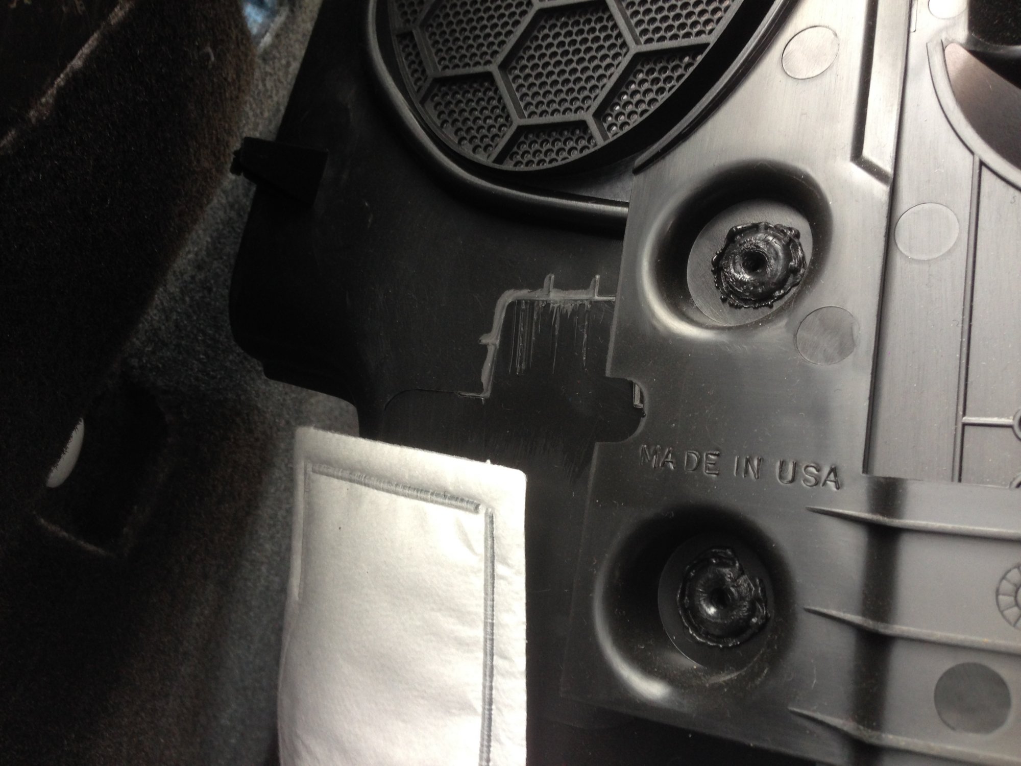

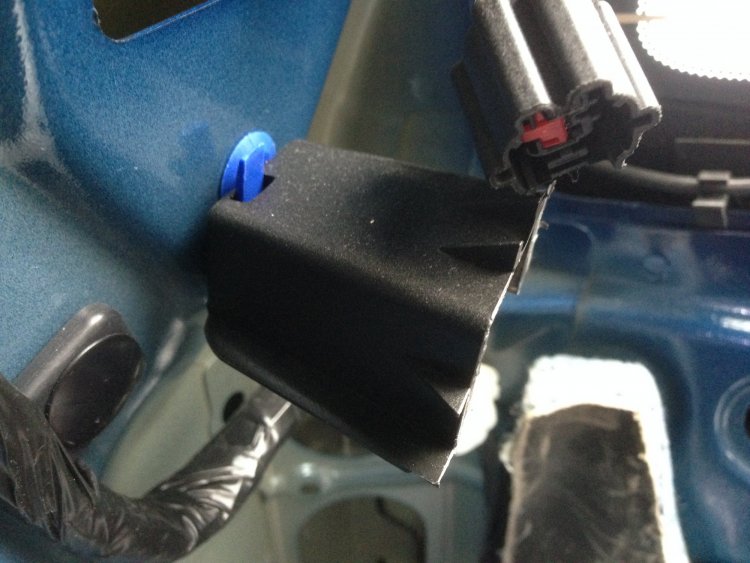

Now the drag, I broke one of the mounting tabs clean off so looks like I'll be buying a new panel unless somebody can tell me how to fix it so it doesn't rattle.
IMG_1467.thumb.JPG.4fef97861fd71ea68eaa24137cb02e72.JPGIMG_1468.thumb.JPG.571aa33947f45b06c88d2ec25a0fa29b.JPG
I broke both tabs you have in the first pic, I used a 2 mixture epoxy to mend it back together. Your second pic I do not recognize the part, but I assume you could use epoxy or try that Flex Glue...the commercial on Flex Glue looks good, I may need to pick up a tube and break something to try it out...LOL!
I used the epoxy on our coffee maker' cradle, which holds the coffee filter basket. So far it's been holding up even with the heat...it's been about 4 months now.

The second pic is the piece that broke off of the piece in the first pic. I'll try some epoxy as I have a feeling that piece is not cheap!

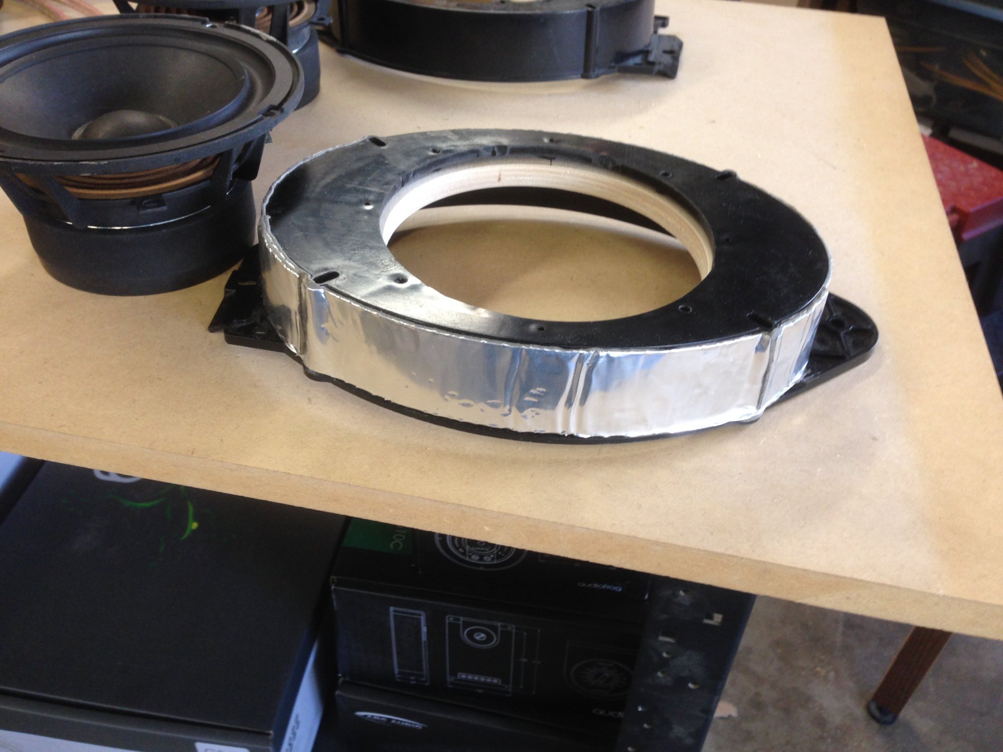

I cheated and started with the flimsy  plastic ones from Metra as well however I reinforced them with a 1/2 birch mounting ring and lined them with sound deadener. After I paint the rings I am going to pack the inside with modeling clay and I will make a gasket from foam weatherstripping. IMG_1485.thumb.JPG.e5153111f00f458eea0b840f1cb97d5a.JPGIMG_1486.thumb.JPG.7ef021540a5f5748fb6b409af9236952.JPG

Come on over to Detroit and make me some sir, I'd thank you. I even have a heated garage that could make it feel like Cali, and not south east Michigan lol. Looks really good though wish I had your skill set. Are the speakers pictured what you put in the door or behind the seat? I'm looking to upgrade my kicker VSS

Those are the 6.5's I plan to use in the front doors with a sub but I am going to experiment with a set of 6x9 components I have first and if that's enough bass for me I won't add the sub.
