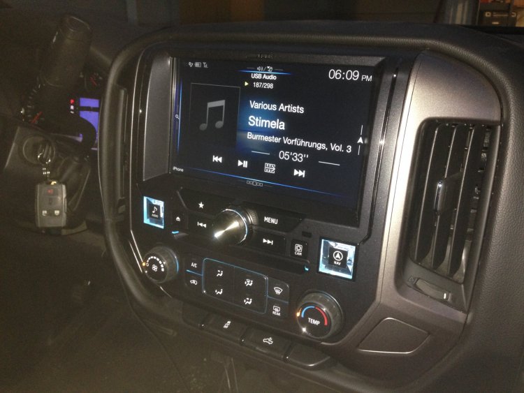

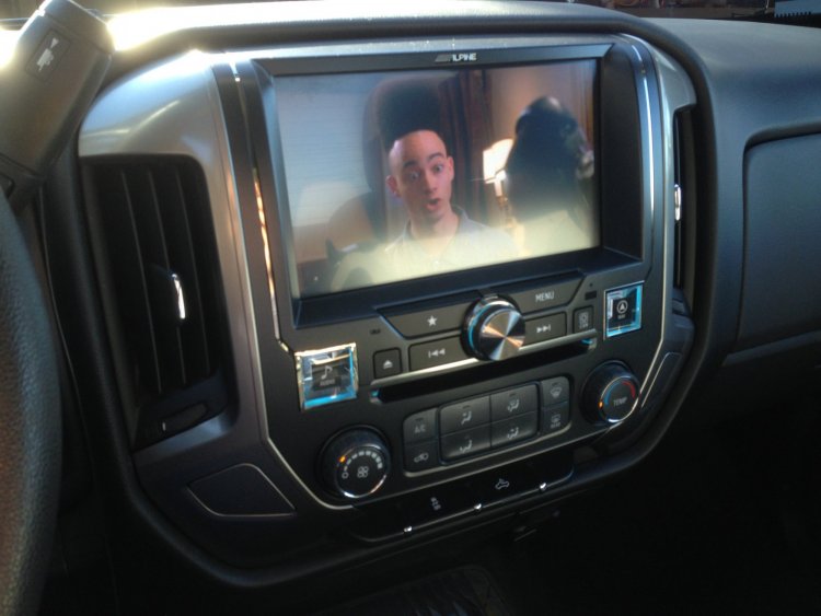

Thanks and I'll be posting more on the audio system I'm working on as soon as I have a chance  to finish it!IMG_1402.thumb.JPG.ff1ba990acf6a1d6d7b57c3e0452b2fc.JPGIMG_1398.thumb.JPG.441119af3326769e92265aa31214ce16.JPG

Sweet! I chose this version since I'm still old school and wanted the DVD/CD player! One thing I forgot to add is the Alpine tech was incorrect when he told me I just needed to add the correct clockspring and steering wheel with controls since it plugged in right at the clockspring. It didn't work so he told me I needed to re program the idatalink Maestro for a truck that came with steering wheel controls since I originally programmed it for my truck with the IOB radio which did not have the option. The Maestro menu showed that the controls were retained but it still didn't work. I then called idatalink Maestro tech support and he told me it would only work if the truck came with steering wheel controls or if the BCM in my truck had the option of steering wheel controls. A call to Chevy service confirmed the IOB radio does not have a steering wheel control option so it is not programmed into the BCM. He said I could get a VIN # from a truck with the steering wheel controls and get a new BCM but if that truck did not have the other exact equipment mine had there was a possibility other functions would not work! This really bites as I did a ton of research trying to get steering wheel controls and got all excited when the Alpine tech told me it was that easy with this system but hindsight of course now tells me I should have called idatalink first since they are the ones that make the module!

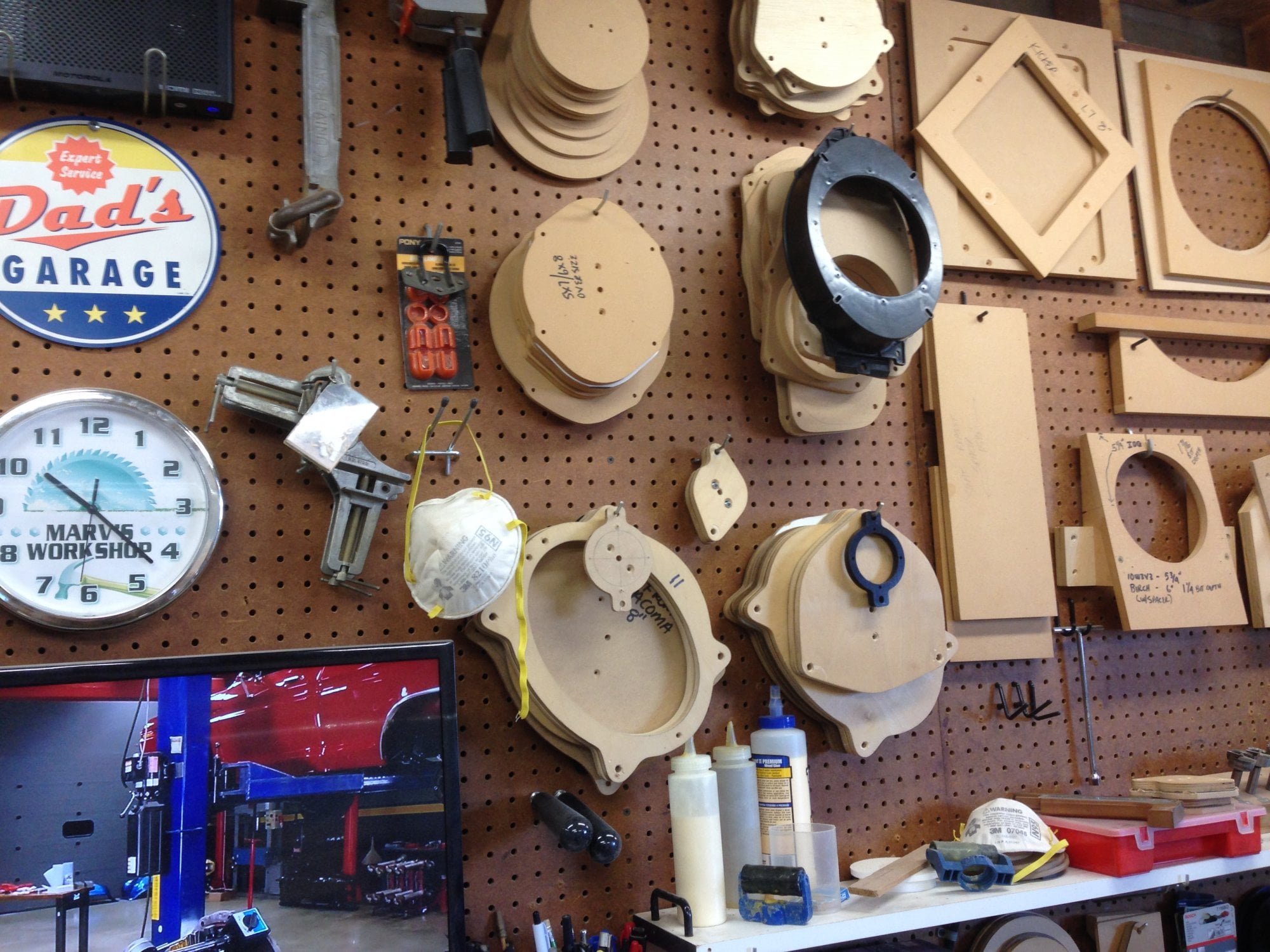

Where did you get those speaker baffles?
thx
thx
From myself. ? (I build custom sub enclosures and also make custom speaker adapters from a variety of materials)IMG_1433.thumb.JPG.960b9952f60e3b86ac300b5fb261ff10.JPG
It's stupid for me, but I always wanted a clock in my garage that was custom like that.  I'll get one for my new garage at the new house.  I like yours!
