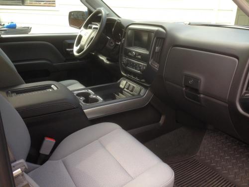

Looks Great Marv!

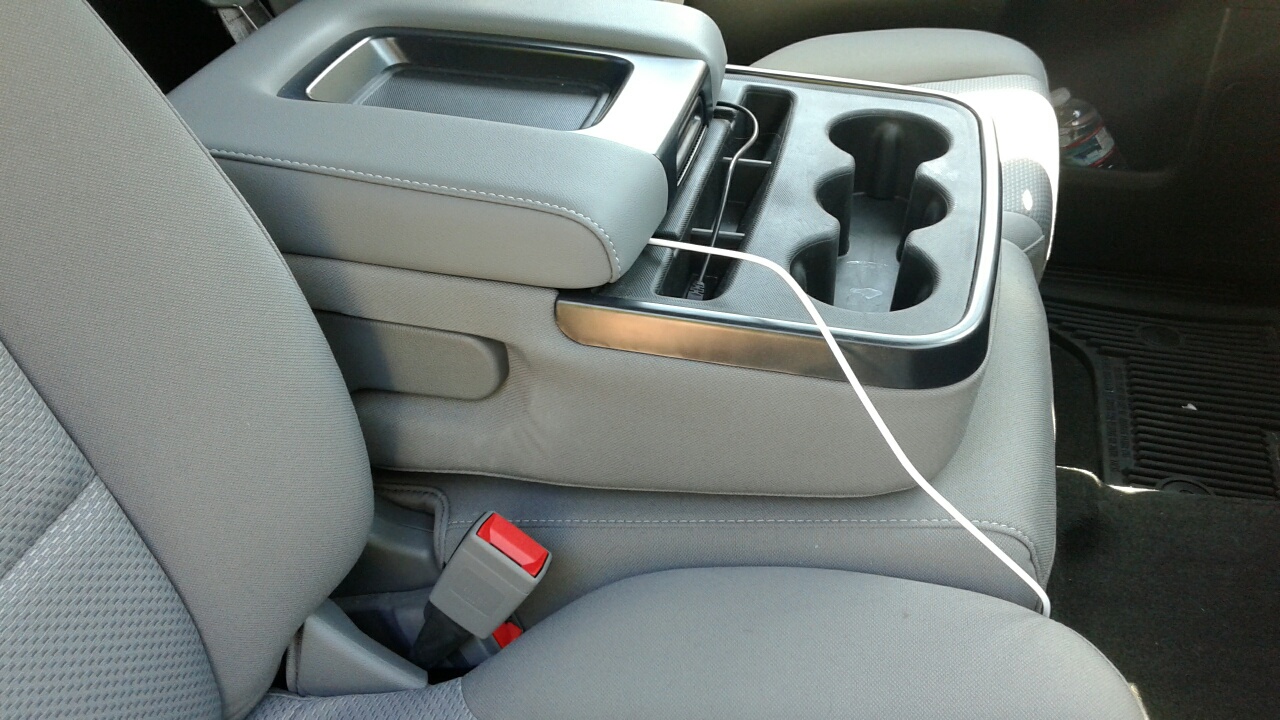

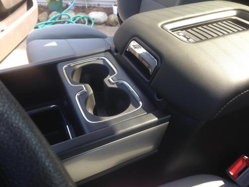

I like the console swap...does it have a locking compartment like the jump seat had on the bottom?
I use that locking compartment often when I need to hide some items.
I just did the GDO on the roof console, which I like very much...no more remote taking up space in the cab.
Oh forgot to mention the bedrug liner is great too! I made some wooden stoppers (corner square pieces) with velcro on the bottom to stick to the rug and hold items in place. Works great and easy to use. When not in use just stick to the side of the bed out of the way.
Good Job on the Build!
Edited by RDKILL
Looks Great Marv!
Thanks RDKILL! Unfortunately there is no locking compartment but there is a company on the forum here that makes a lift out organizer tray that closes off the storage compartment under the lid.

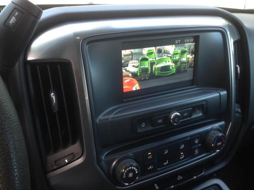

Thanks! So far I just have the adapters made for the new Hybrid Audio Technologies 2 3/4" mids to drop in the dash as well as door adapters for the 6x9's but I haven't had much time to work on the rest since I've been too busy working on everyone elses systems. I made a couple more changes in plans and will be using a Match 6 channel amplifier with built in dsp connected to the factory headunit as well as adding a cd/DVD player with a custom programmed module that allows audio/video/hdmi input. I also have a new sub enclosure design in mind so I have the other 2 I already built but won't be using if anyone is interested in them. The one shown is all high grade birch built to specs for a JL 10TW3 on one side and a custom tuned passive radiator on the other side.  I also built an identical one for just the 10TW3 mounted in the center and either can be installed alone in the center with a simple mounting platform I made, have an amp rack on each side or be installed behind one seat with a longer amp rack on the other side. (I'll be posting more pics on my Instagram @mrmarvsplace as soon as I get time to put the finishing touches on those and build yet another one!)
Marv,
is your display factory? I have the smaller non-touch but the $1,000 price tag to upgrade will be going to headers or a nice projector headlight.... I really like the sub box though. Great work sir.
