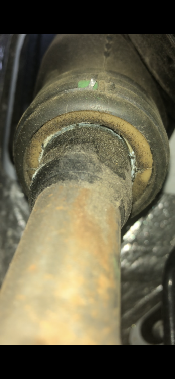

Well I just came back from the dealer, it's not this he had me look himself. There was no black exhaust anywhere around that clamp, so cross that one off. The noise is still a mystery.
Well guys, just got my truck back. The noise is gone, I've tried to get it to it several times and it's not there. The tech and I looked along the entire exhaust and there was no sign of any leaking. What he did do is replace my steering shaft for a funny noise it was making, that's about it. When I was underneath the truck, I hit the driver side cat several times with my fist to see if I could hear anything loose inside it, that's the only thing I did.
I couldn't believe driving it home not hearing a damn rattlesnake coming from my footwell. It might come back, who knows but all I do know is this truck has made the sound since it had a few hundred miles and I have 10K now still doing it until this most recent visit to the dealer. Just thought I would share and tell you guys knock on your driver side cat a little bit and see if that does anything

I don't see how it could, but it stopped after the shaft got replaced. What I know is I banged on the cat with my fist, and that shaft got replaced and it's gone now.
