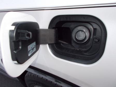

Doesn't mean they can't design it properly from the ground up. My '18 Traverse has a properly designed capless system with a baffle on the back of the fuel door that fits neatly into a recess protecting the cap area from water dirt and dust plus an interlock to warn if the door is open while driving away. Bottom of the filling hole is tapered outwards so pilled liquids or a driving rain while the fuel door is open will not remain up against the closed door and the hinge area is encapsulated instead of the Silverado's hinge which opens directly into a hole inDSCN0351.JPG.627a56f57b9564a47f8a3171365e14e5.JPG the inner fender open directly to the ground. Outer body covered with road salt and road crap, but the fuel filler area remains clean as a whistle.
