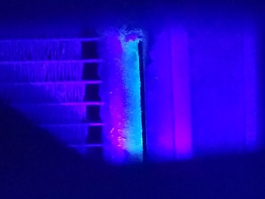

Damn I got the a/c leak virus!!! And I live in Houston!!! I haven't taken anything apart yet, i still had a bit of pressure the first time I started getting hot air, so I just added more refrigerant. The second time I went to auto zone and "borrowed" their manifold gauges and vacuum pump. The system held vacuum for about an hour. So I recharged it. Lasted a week. Now I went to harbor freight (I think I'm starting to like that store) and bought the gauges to be able to see what's going on. Tomorrow I'll be pulling vacuum to see what happens, but I feel like if it is the condenser, I might be able to hold vacuum again... is this a good hypothesis?
2015 Texas edition, 37,000 miles. No extended warranty. I feel like I could give this repair a try, I'm inclined to turn wrenches and know a bit about HVAC, so I'll start looking into it. But I'm so disappointed in GM. I always wanted a Chevy truck, but not like this.

Get a flashlight and peer through the grill to get a look at the condenser. If there is a leak, you should see a wet oily area near where the leak is. Mine was on the driver's side up at the braze/weld where all of these condensers seem to have the leak...
