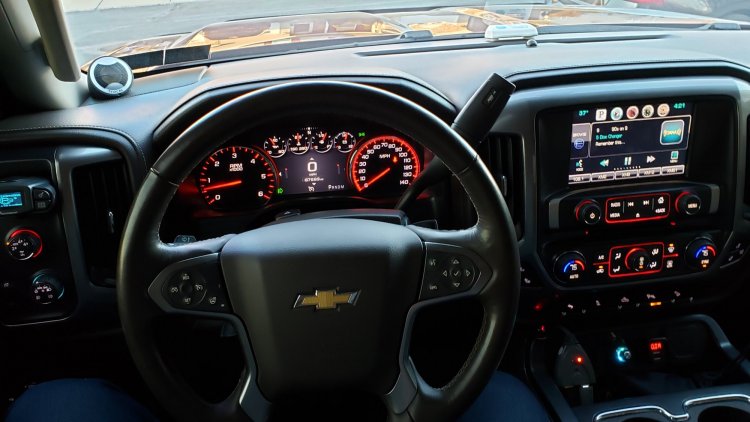

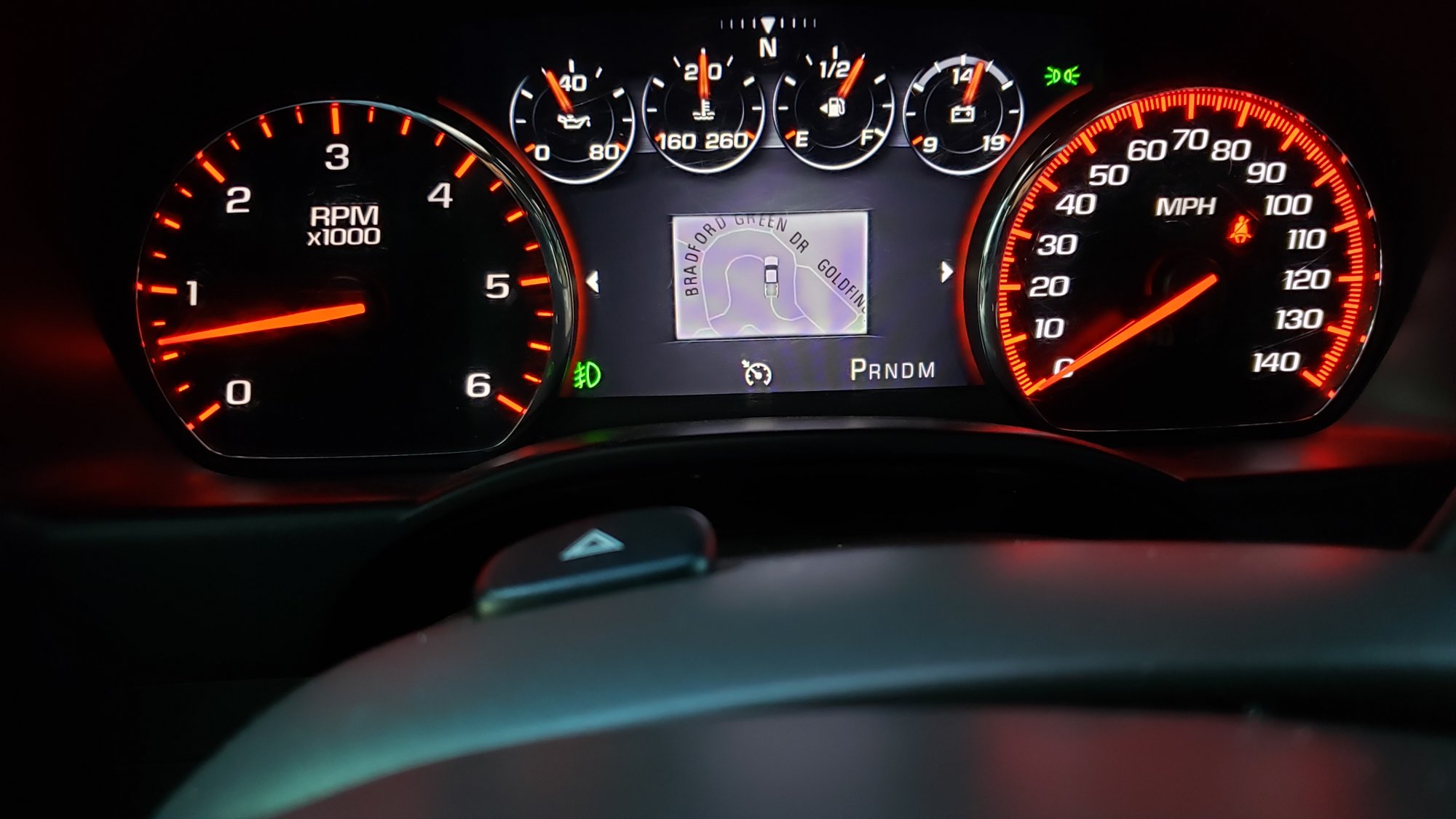

RACERX7775 Posted January 16, 2019 Share Posted January 16, 2019 Well, thanks to WAMS, I got my cluster today and installed it. There is a couple things... I lost my trip info. It has the trip info from the original truck the cluster came out of. Which i wish I really had. I reset it all the day I bought it. So trip B had totals from the day I bought it. Trip A was weelky fill ups and mpg's. I also lost my engine hours. Dont know how that happened. I do like the nav screen showing the map though. Now I just have to get the RED ORL switch. 1 Quote Link to comment Share on other sites More sharing options...
SS502 Posted January 16, 2019 Share Posted January 16, 2019 (edited) 16 hours ago, RACERX7775 said: Well, thanks to WAMS, I got my cluster today and installed it. There is a couple things... I lost my trip info. It has the trip info from the original truck the cluster came out of. Which i wish I really had. I reset it all the day I bought it. So trip B had totals from the day I bought it. Trip A was weelky fill ups and mpg's. I also lost my engine hours. Dont know how that happened. I do like the nav screen showing the map though. Now I just have to get the RED ORL switch. Looks great! Now I gotta find out how the Nav thing works lol Stupid me...it’s selectable ? Edited January 16, 2019 by SS502 Quote Link to comment Share on other sites More sharing options...
ForgedDuramax Posted January 18, 2019 Share Posted January 18, 2019 On 1/15/2019 at 9:55 PM, RACERX7775 said: Well, thanks to WAMS, I got my cluster today and installed it. There is a couple things... I lost my trip info. It has the trip info from the original truck the cluster came out of. Which i wish I really had. I reset it all the day I bought it. So trip B had totals from the day I bought it. Trip A was weelky fill ups and mpg's. I also lost my engine hours. Dont know how that happened. I do like the nav screen showing the map though. Now I just have to get the RED ORL switch. How did you switch all the other lights around the radio/hvac controls to be red to match the cluster? I see you have a chevrolet, which I know all of them came with the teal color.. I have a cluster coming and would love to do this mod so the rest of the buttons are red. Quote Link to comment Share on other sites More sharing options...
RACERX7775 Posted January 18, 2019 Share Posted January 18, 2019 (edited) I was lucky enough that another great member on here with a sierra wanted the blue. We made arrangements to remove the radio screen with controls, hvac controls, headlight switch, and 4x4 switch from both of our trucks. Then ship them to each other, via ups 2nd day air. So the cost to do the mod for me was $57 for the shipping. You can remove everything and still drive the truck. Everything still worked via steering wheel controls. Except the hvac. But i set it to 75 and auto. So when i unplugged it, it stayed on that setting. I still have the blue ORL headlight switch because I want to see if someone has a red one for sale, or someone wants to trade blue for a red one. Thats the only way to do it. The cluster still shows Intellilink when started. And i lost my engine hours. Chris said that info is inside the cluster and cant be transferred. Same with the Intellilink logo. But, when i get rid of the truck, the denali cluster will come out and stock cluster back in. Edited January 18, 2019 by RACERX7775 1 Quote Link to comment Share on other sites More sharing options...
SS502 Posted January 18, 2019 Share Posted January 18, 2019 (edited) 22 minutes ago, RACERX7775 said: I was lucky enough that another great member on here with a sierra wanted the blue. We made arrangements to remove the radio screen with controls, hvac controls, headlight switch, and 4x4 switch from both of our trucks. Then ship them to each other, via ups 2nd day air. So the cost to do the mod for me was $57 for the shipping. You can remove everything and still drive the truck. Everything still worked via steering wheel controls. Except the hvac. But i set it to 75 and auto. So when i unplugged it, it stayed on that setting. I still have the blue ORL headlight switch because I want to see if someone has a red one for sale, or someone wants to trade blue for a red one. Thats the only way to do it. The cluster still shows Intellilink when started. And i lost my engine hours. Chris said that info is inside the cluster and cant be transferred. Same with the Intellilink logo. But, when i get rid of the truck, the denali cluster will come out and stock cluster back in. It looks great! I saved my stock cluster too...my engine hours reset too but I did mine so early it might have lost 15 hours...my “best MPG” took about 50 miles to re-register a best too but all good now. The bonus for me was after the swap (and I do not know why) my Intellabeam headlights started working...was gonna take it into dealer but they started working immediately after the swap...probably just a fluke. Anyway, the red looks very nice. Edited January 18, 2019 by SS502 Quote Link to comment Share on other sites More sharing options...
RACERX7775 Posted January 18, 2019 Share Posted January 18, 2019 (edited) Yeah. I had over 2600 hrs on mine. I totally wish I had intellabeam high beams. Wish i could add them.... Edited January 18, 2019 by RACERX7775 1 Quote Link to comment Share on other sites More sharing options...
RACERX7775 Posted January 18, 2019 Share Posted January 18, 2019 Oh, when i did the swap, before i removed the 4x4 switch, i set it to auto. Then it snowed the next day. It showed service 4wd, but the system worked perfect. Quote Link to comment Share on other sites More sharing options...
SS502 Posted January 18, 2019 Share Posted January 18, 2019 2 minutes ago, RACERX7775 said: Yeah. I had over 2600 hrs on mine. I totally wish I had intellabeam high beams. Wish i could add them.... Wow that’s a lot of hours to lose but I guess you could plug the old one in to get exact hours when you combine the two for your records...I love the Intellabeam, it works way better than I thought it would. Quote Link to comment Share on other sites More sharing options...
RACERX7775 Posted January 18, 2019 Share Posted January 18, 2019 (edited) Well, my truck has 87600 miles on it now. So i think thats average hours. Whenever i sell it and swap it back, itll be like having low hours. Unless its stored somewhere in the ecm, but not displayed. I have a snap-on verus scanner. Ill have to hook it up and check. Edited January 18, 2019 by RACERX7775 Quote Link to comment Share on other sites More sharing options...
