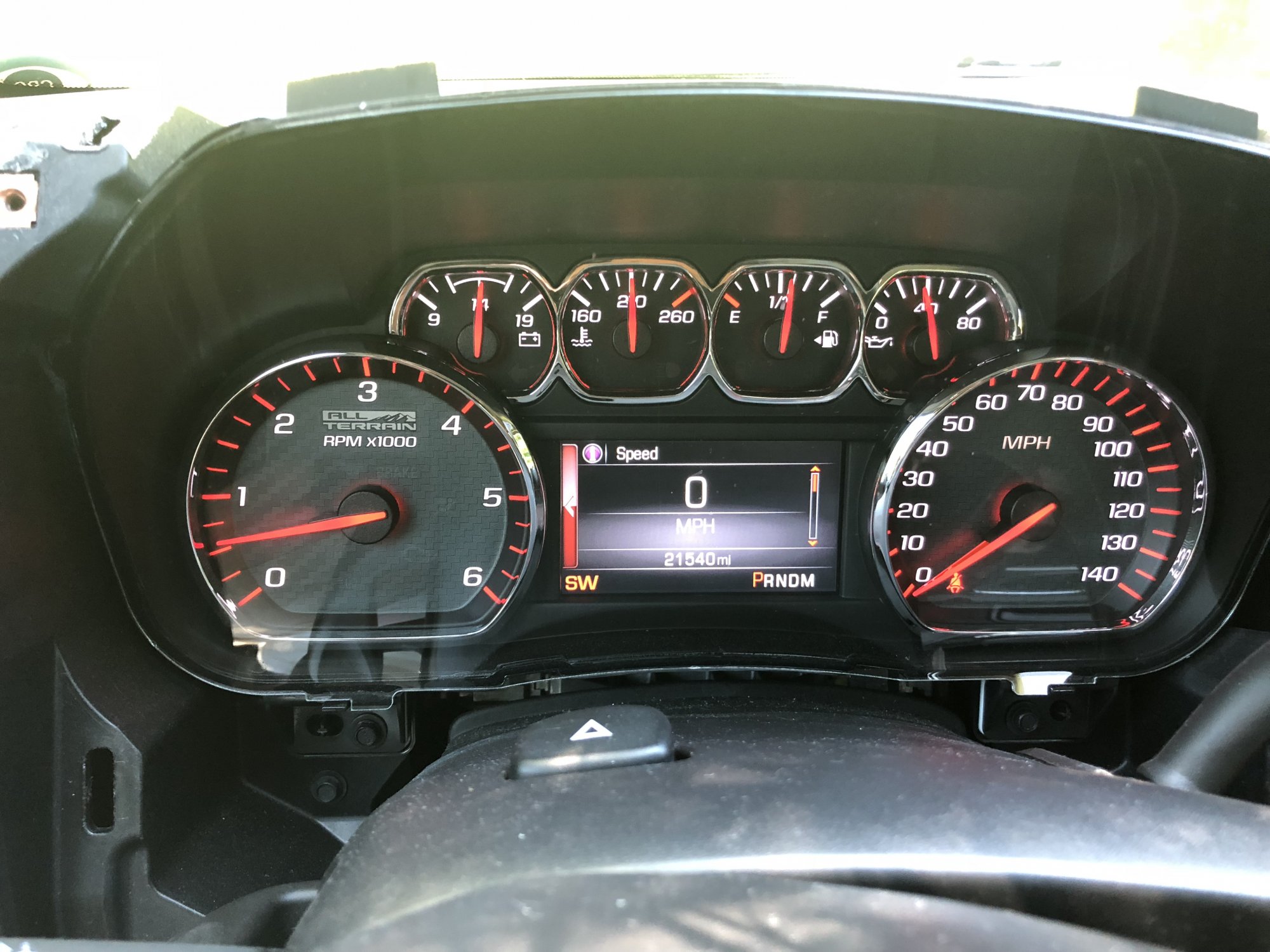

bsprtsgrp Posted July 2, 2018 Share Posted July 2, 2018 (edited) On 6/13/2018 at 10:10 AM, bsprtsgrp said: Ordered my 2015.5 #84254161 Denali Cluster yesterday from my GMC Dealer, should be here end of week..... Received my new 2015.5 Denali Cluster from my GMC dealer last Thursday and shipped same day to Chris White in MI via UPS which he will receive today... Before picture... Edited July 11, 2018 by bsprtsgrp 1 Quote Link to comment Share on other sites More sharing options...

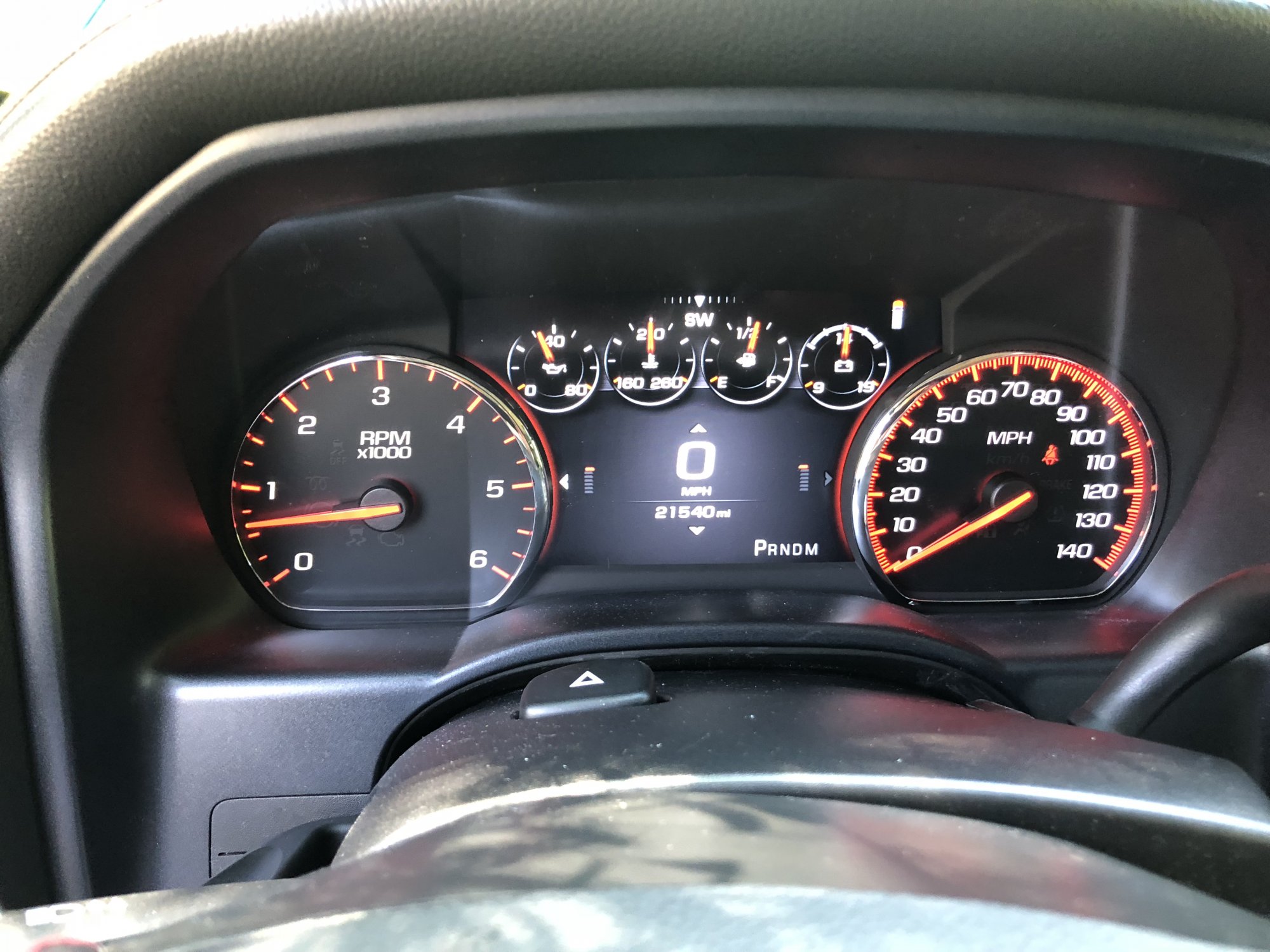

bsprtsgrp Posted July 11, 2018 Share Posted July 11, 2018 (edited) Installed...thanks Chris White! Edited July 11, 2018 by bsprtsgrp 3 Quote Link to comment Share on other sites More sharing options...
GTPprix Posted July 21, 2018 Share Posted July 21, 2018 Installed...thanks Chris White! You’re welcome!!! 1 Quote Link to comment Share on other sites More sharing options...
