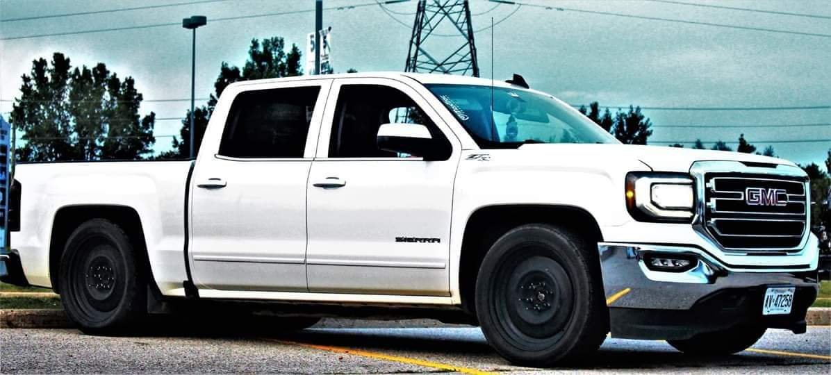

Updated. Moved the rear kit to the 6" setting. We are now 3/6 drop.
Kit is a mix of parts
DJM front lower control arm
Belltech strut front set to 1" drop
Rear Maxtrac flip kit set at 6" setting
Rear Belltech shocks
What's the part number for the lower control arms, I can't find them

Hey guys, I have a 2016 High Country 4x4. installed a INEZ hotrods control arm drop and flip kit 4" up front and 6" rear. I dont like how i lost some steering radius it is driving me nuts and I want to change it for a kit with no loss to steering radius, I never would have ordered it if I knew this. Anyone installed a McGaughy's Suspension drop 3/5 are there issues with steering radius when installed?
IMG_9227.thumb.JPG.5f10a1fa6c1f373f5f06eec1c803c7a4.JPGIMG_9238.thumb.JPG.07ea3ec9b043b60fe587ab3fda326d3d.JPG
Both the McG or Belltech spindles will improve the steering radius over the IHC arm set up - I would have to imagine you rub a lot on the back side of the fender liner with that tire set up too which won't help either.
