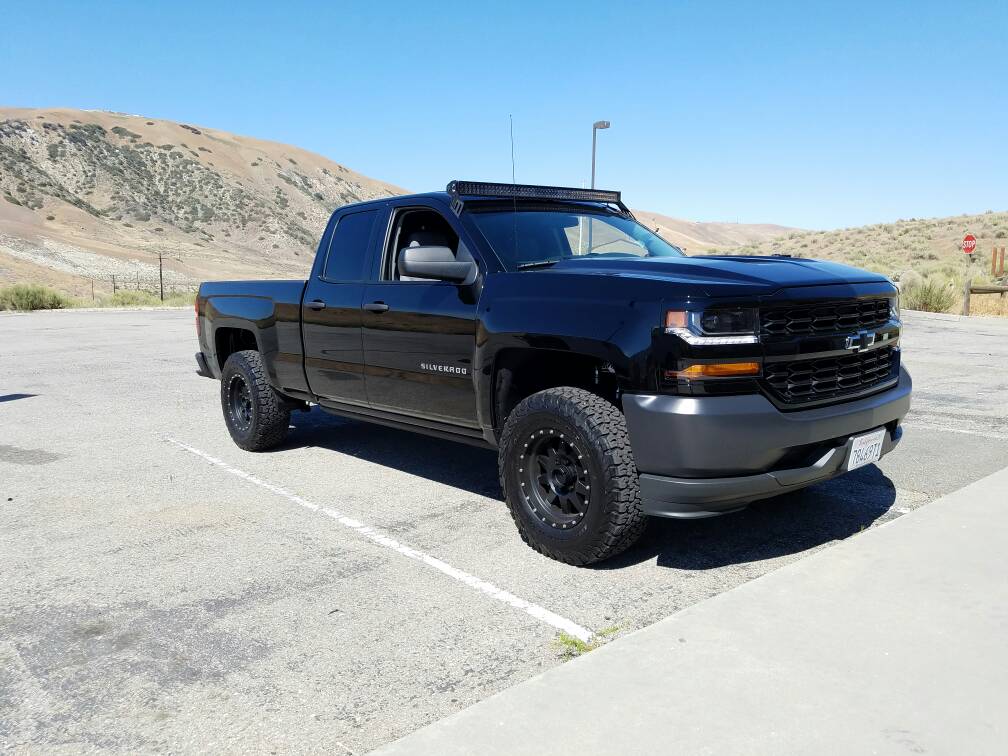

I have the Camburg 2.5 kit and love it. Its a bit pricey but well worth the money. Just went off road yesterday and its night and day with how it rides. https://camburg.com/shop/suspension
Sent from my SM-G930P using Tapatalk
Thanks for the input. I'll check them out. Your truck looks good!
