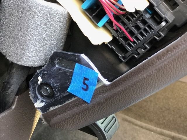

Mine had the same issue under the steering wheel when I bought the Truck, I love how you can see the blue mark where someone actually checked off after it was tightened. They need to adjust their screw gun at the factor.
Yup two bolts were loose... requires a 7mm socket. Bottom left one was barely in
