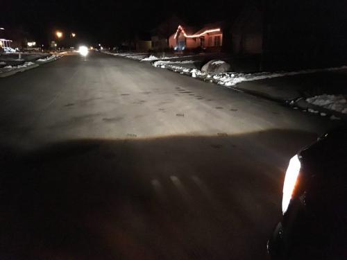

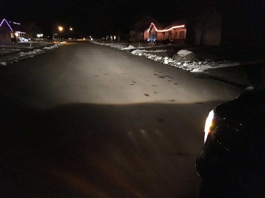

Here are my results from the PIT5374B headlamp update. Not super impressed, but it is better than before.
It is really hard to see the improvement in the picture and videos I took, but I did see a small improvement. It didn't seem 30% brighter, but as you will see in the picture, it had a wider distribution of light so you can see more of the road.
Before picture: http://i.imgur.com/mbK91emh.jpg
After picture: http://i.imgur.com/5APlH38h.jpg
My dashcam really doesn't give much justice here. It truly looks a lot better than you see in the videos. It's the best I could do though.

The "after " picture looks to show a noticeable improvement over the "before" shot.
On the videoes, neither look to be all that impressive, could just be your dash cam.
What did you think of the "After" nighttime driving/lighting?
Here are your before & after shots for a comparison view:
Thanks for posting them like that. A lot easier to see the difference.
I almost didn't post the videos because my camera doesn't capture the true lighting.
Overall: any improvement over the stock is worth it. I would recommend this update to anyone. There are a lot of dark rural roads where I live and that's where the upgrade really helped me. There is better coverage now and I'm not straining as much to see what's in front of me. The high beam has improved too. Again, most noticeably in the width of light, but also in the intensity at distance.
