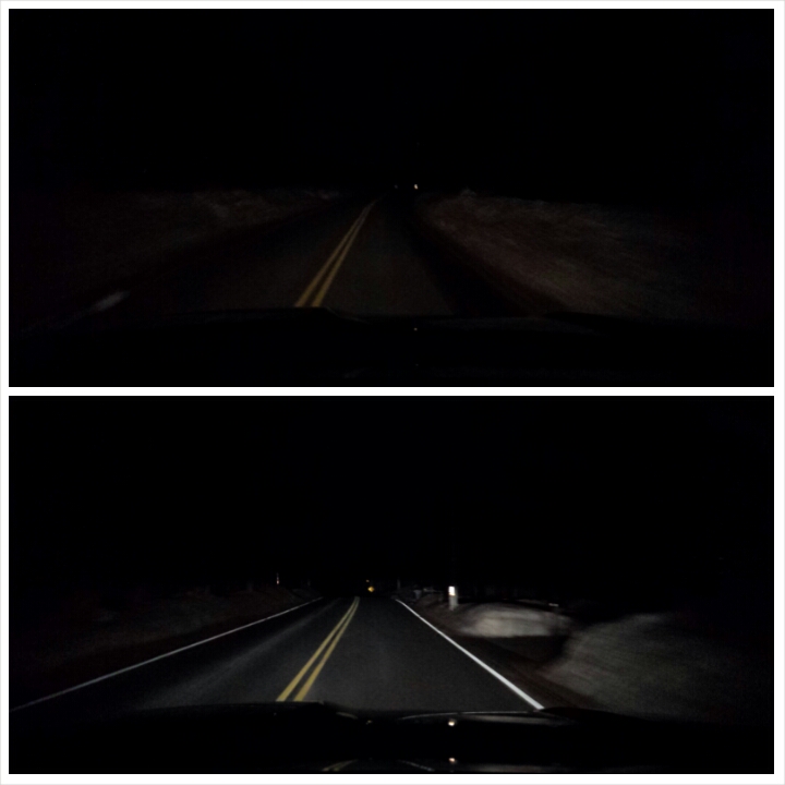

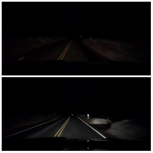

Just returned from trying out the new lights, took my wife with me to help get a better idea. We live out in the country so got a good look as soon as we pulled out of the driveway.
First impression, a lot brighter and much better illumination off to the sides where it was virtually nonexistent before. Overall we're very happy!
I would definitely recommend having this done to your truck!
