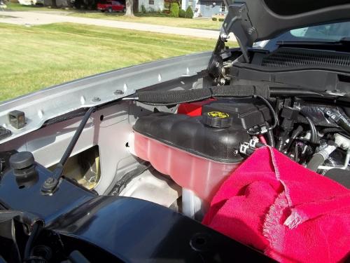

Here are a few pics of the location of the HID components installed. (Used Fondupot's YouTube video as a guide.)
Routed the wires to the Pos. & Neg. terminals on the battery along the right fender, using the brace to secure the power wire.
Mounted the relay/harness with 2-sided tape to the backside of the grille, just to the right of an opening (to lessen the chance of any water or snow getting directly onto the relays. Also mounted the ballasts on the shroud between the grille & radiator support. (Didn't need to use the extension cable to reach the driver's side ballast.)
Pic of the driver's side headlight housing with the igniter mounted on the right side with 2-sided tape. Wires go up to the ballast mounted on the shroud.
After reading elsewhere on the forum, I went and changed my vehicle settings to avoid having the HID's come on for short periods of time-turned off the exit lighting and light flash for keyless door lock operation.
