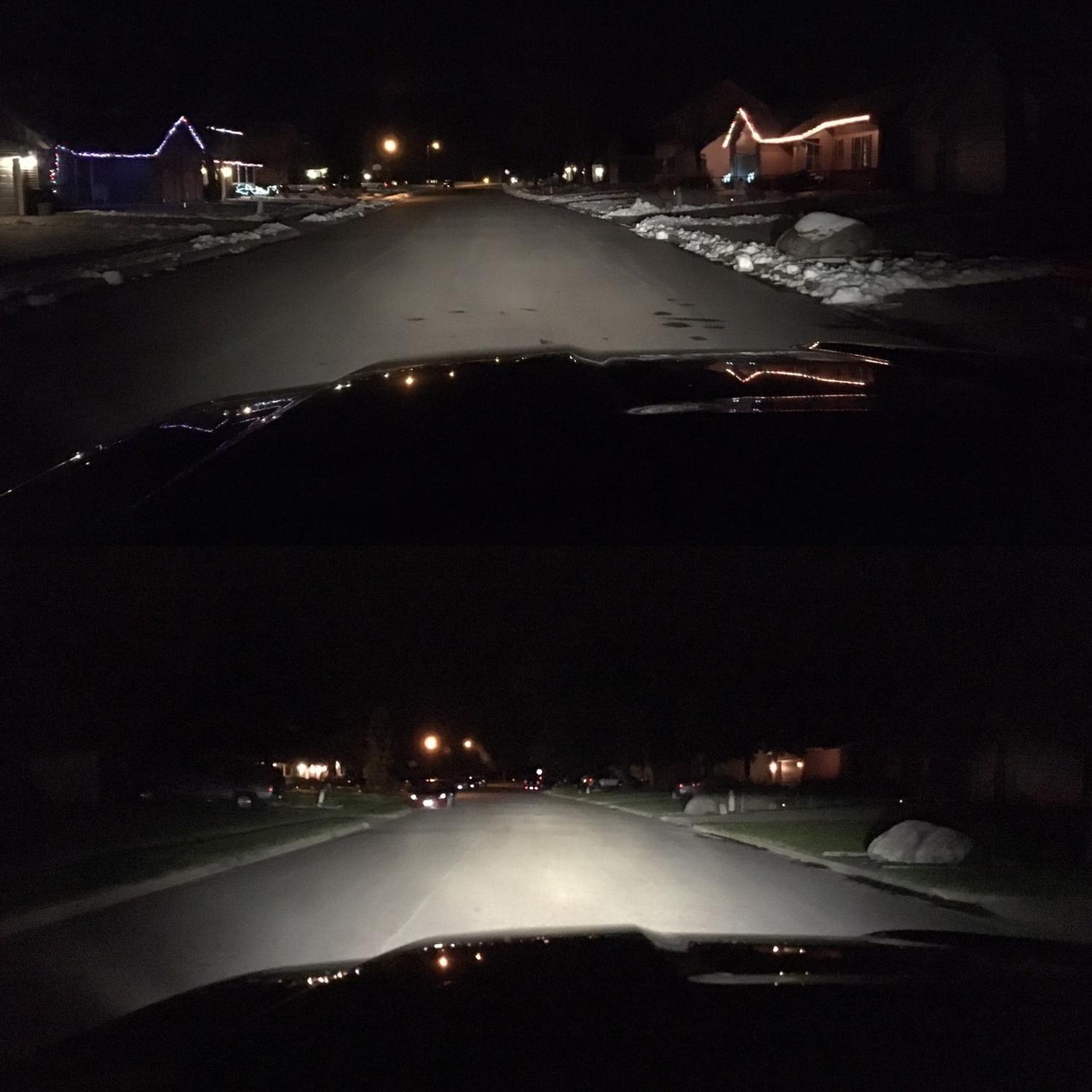

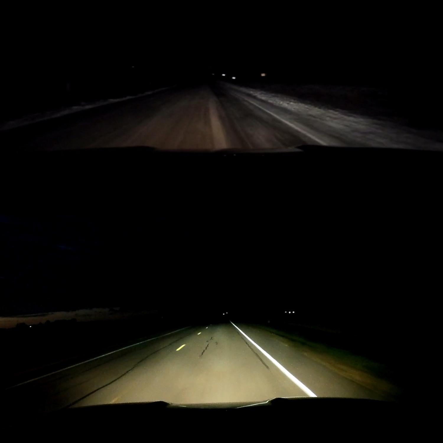

I did an upgrade on my Hayabusa a few years ago and loved it. I went with the 5500 but it was a bit to much in traffic. I bought a new left over 2014 GMC in January of this year. They did the so called upgrade to the lights but they are still crap. I see better with the lights on low beam with the fog lamps on then on high beam. I did notice the lens gets hot now. Do you have that issue? I want to do this upgrade just have't got around to it. I still think GMC should do something about it. I really don't feel safe driving at night. Are the thumbnail pics on low beam? Thanks for the info.
Yeah that dealer 'fix' did not make any significant improvement.
The first picture has low beam with dealer fix on top, then low beam with HID before I re-aimed them on bottom.
The 2nd picture is low beam on both.
I have no over heating issues with the 35w kit. Also no glare that would affect other traffic. Just solid excellent lighting at night. That's why I recommend the 35w over the 50w.
