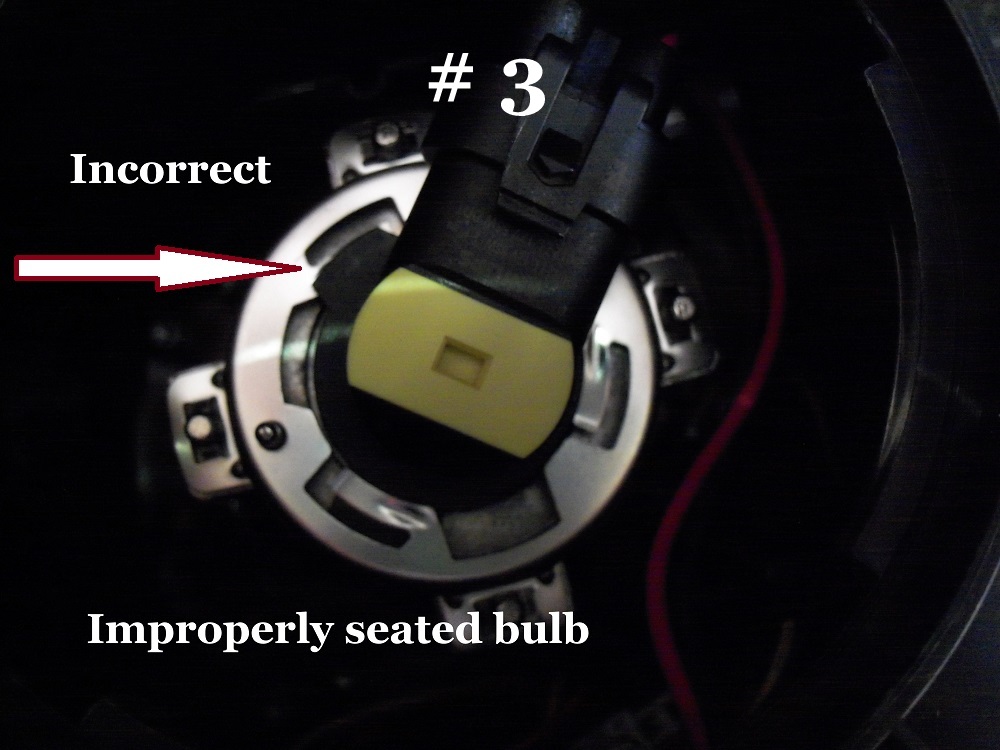

Had the tsb done on my truck Saturday, now with the first time driving the truck in the dark, it seems to be no better, maybe worse-can that be?
Checked the driver's side bulb and it is the Vosla, where the original was a Phillips.
Is there a specific orientation of the bulb when installed-currently they have it where the plug end is up at the "1:00" location.
I had the same conversion done, same crappy lighting GM really needs to do something! Lighting is disgusting and unsafe!
I can't see mine right now -- the truck is covered with snow! But the tabs and slots only line up one way, so if you remove it, and re-install it so it locks in tight, it will be the "right" way. Someone who can get to theirs right now can say if that is, or isn't, at the 1 o'clock position.
There have been reports on the thread of people having the bulb re-installed only part way into the hole, which causes the projector to aim the light incorrectly, scattering the focus.

Here's 3 pictures and instructions I did up for you guys.
First, turn the bulb counterclockwise as if you would be removing it until all 3 black plastic tabs on the bulb are showing and the bulb is loose. Illustration #1
Turn bulb clockwise until it stops and be sure all 3 black tabs are under the metal spring clips. Be sure the bulb is turned clockwise until it stops at 1:00. #2
Illustration #3 shows an improper seated bulb as the black plastic bulb tab is over the spring clip and not under it. Check all 3 plastic tabs to be sure they are under the spring clips.

mafd2, thanks for the pictures of the bulb installed correctly/incorrectly.
Checked my driver-side bulb, was installed correctly, assuming the pass.-side is as well as the light pattern when shown on my garage door looks the same.
Still thinking something amiss if the Vosla upgrade should show an improvement.
