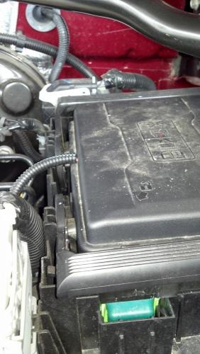

You don't need diodes. Here's what I did on my '14 Sierra. Get a set of H16 female connectors (link below). Run a ground then to 12V source. I ran it to the fuse box with wire loom using a micro 2 fuse tap (link below) to fuse box shown below. This way the fogs come on when the truck is started and stay on whether on high or low beam and don't have to turn them on every time you start the truck as it is now. The factory harness or wiring isn't altered and no diodes to mess with. If you wanna go back stock, just plug the factory connectors to the fog lamps.
http://www.ebay.com/itm/5202-H16-2504-PS24W-Bulbs-Female-Connector-For-Fog-Lights-Wiring-Pigtail-Harness-/321234215123?hash=item4acb0d20d3:g:tDkAAOSwirZTrv4H&vxp=mtr
http://www.ebay.com/itm/NEW-ADD-A-CIRCUIT-ATM-MICRO2-ATR-FUSE-TAP-USA-SELLER-FREE-SHIPPING-/221517824774?hash=item33937dc306:g:5I0AAOSwQItT5Nxc
