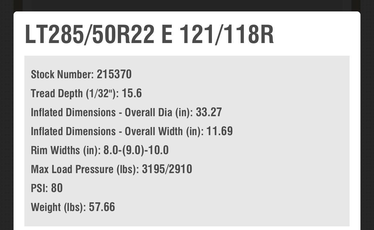

I was wondering about the 285/50/22 myself.  I see they make a terra grappler g2 in this spec.  Has anyone tried these?
Love the way these trucks look with the 22's and some AT tires.  Would the 285/50/22 eliminate rubbing or trimming? Thinking about the RC 2.5 level/lift kit.  Also could you add a small spacer to push the wheels/tires out to help with full lock rub?
