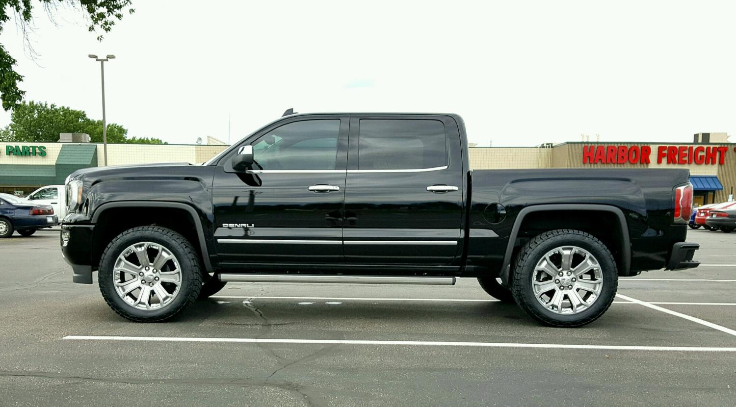

Here is my 2017 Sierra Denali with leveling on 285/55/22 G's. No trimming. Rubs a bit when backing up my driveway. I might do a bit of trimming. I haven't decided yet. Love the look though.
Which leveling kit are you running? Wanting to add 2.5/1 leveling kit to add the same Nitto G2 tires you have. Really like the Rough Country 2.5/1 kit but just spoke with them and they don't yet have a kit to market for the AVV stamped steel HD control arms on my 2017 Sierra Denali.

Dang! I'm running that same tire (34.4" tall) on a 4" Fabtech. Where does yours rub? Driver or pass side ?

I'm running a Terra Grappler G2 in a 285/55/22, which measures out to 34.4", only .2" smaller than a true 35". It's roughly .5" thinner. I chose to run a 1" spacer and I am really happy with the look. You will read people go back and forth with their opinion of/on spacers. I did my research and I am happy with my decision. I may at some point get wheels but I wanted to keep the OEM look, just a little more aggressive.
My Denali is a 2017 1500, crew cab, short bed,
4WD.
I'm running the factory 22" that comes with the Denali ultimate package.
I have a 1-1.5" section of my fender liner where I rub on the driver side when I turn left in reverse. I haven't trimmed anything else or removed the lower bumper valance.
I was really surprised when the other member was running this tire on a level kit. That's a massive tire on just a level. It has to rub ..The kit I have is designed for 33s, and it seems like it barely fits the tires I run... I had a 2.5 level before this and there's no way they would have fit.
I'd highly recommend the Fabtech kit. It integrated nicely with Magnaride and I truly think the majority of the additional roughness is from the 10ply tires. I'd say it rides like a 2500 HD.
4WD.

I added the spacer for the look mostly. It's the same front and rear and it looks pretty solid. I ran a SuspensionMaxx 2.5" level. I loved it and the bracket for the relocation of the level sensor was good. It was actually accidentally transferred to the Fabtech control arms and it ended up making my whole lift ride better because it put the sensor at a better angle. Here's the truck with the level.
The ride was pretty much same as stock. The only time I could feel a difference was at 75+mph and I think the aerodynamic change was the biggest difference.
I would highly recommend a true lift for such a size tire. Yes, it could technically fit on just a level, but it really doesn't make a lot of sense to limit the movement of the suspension that way. But I built this truck to be able to drive through a ditch if I feel like it... haha you know what I mean though.
Here's the truck with the Fabtech 4". I'd highly recommend this set up. I'll take pics of the upper ball joint if you want. It's solid.
