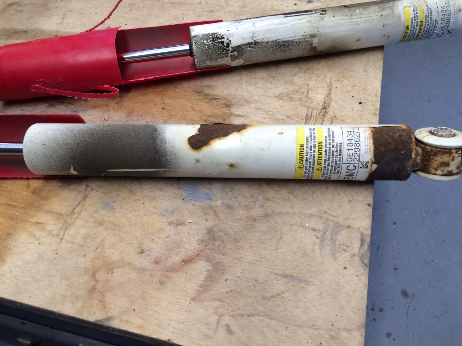

Thanks for posting video "very cool". It may be an optical illusion but at around 6.38 when the tire just starts to turn it looks like the tire tread is not square with the wheel and is wobbling a bit. That is what my vibration feels like "a tire". Makes you wonder if these larger size and width tires that have become so popular on new vehicles might be partly to blame, it would seem to be a real chore for a tire manufacturer to make a tire perfect. Anyway wanted to report i installed the new Gabriel Ultra shocks to replace my rusty ranchos on the rear and drove a day and could tell no difference. Then I installed the leaf spring clamps 5" in front of the axle and can still tell no difference. My truck still has the slight shake at 70 with no apparent change after Torquing of the axle ubolts / new shocks / leaf spring clamps. Seems like I wasted my time and money but the new shiny shocks do look better LOL. Ranchos were both leaking at 57k miles and were very rusty Note that I live in middle TN not the northern rust belt.
