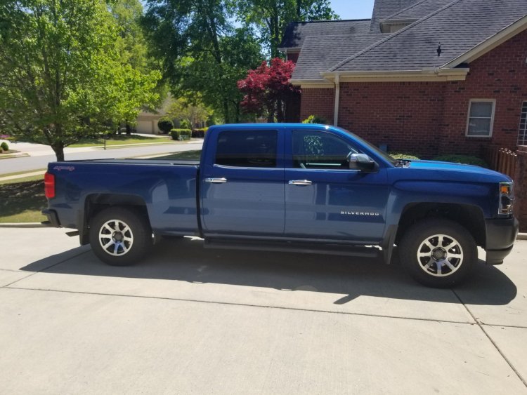

My truck doesn't let you select 4wd without prompting you to go into neutral on the screen. Yes, I meant to post here because of my shake at ~40-50mph. Put it in 4lo to crawl out of a mudhole in the driveway. Thanks for the info!

Your issue is probably a little separate but would be nice to see your vibration now in a video; If its a similar vibration we can probably narrow the shake to the front end like I've suspected for a while now.

I had my driveshaft trued and no more shaking!
RT
Before you had your driveshaft balanced and trued, did you ever put your truck in neutral to see if the vibrations/shakes quit? On my previous truck, 2000 Silverado z71, the driveshaft was so out of balance and u joints were so worn, whenever I put it in neutral going down the road, the vibrations immediately stopped.
Where do you feel the shakes most, seat, steering wheel, or console? I have a 17 that shakes occasionally too.
Sorry if you've already mentioned it elsewhere.
Np, I feel it in the seat cushion and seatback. My wife felt it too so I know its bad.
