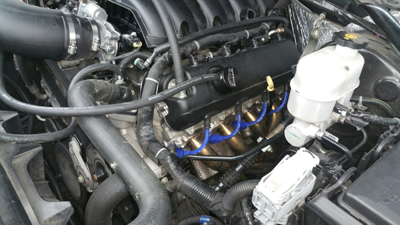

Well, we installed the Kook's headers & cross-pipe this morning! The truck sounds healthy without being overly loud. I ordered the wires yesterday after several of you responded, thanks. I will let everyone know on the fit and take some pictures then.

any of the wires "too close for comfort" ??
If they're anything like my 06 there won't be an issue with the headers melting the wires. I've ran headers on my 05 and this 06 with no protection, and have never had one melt.

They are rated to 600 degrees but i would rather not have to find out the hard way that they melt. I saw a member on here have little boots like a shield for his. Maybe just a precaution?

Nope. That was my concern as well. That is the reason I went with the 135 degree boots vs the 180 degree boots. The extra angle vs straight allows the wires to tuck in more.
Check the price on those fire sleeves...... I thought about that as well, the sleeves are ugly and are not needed. On the factory set-up, the boots are straight and you are using cast iron manifolds that are shaped differently.

You could always add them. Better safe than sorry, but I think you'll be fine without them.
