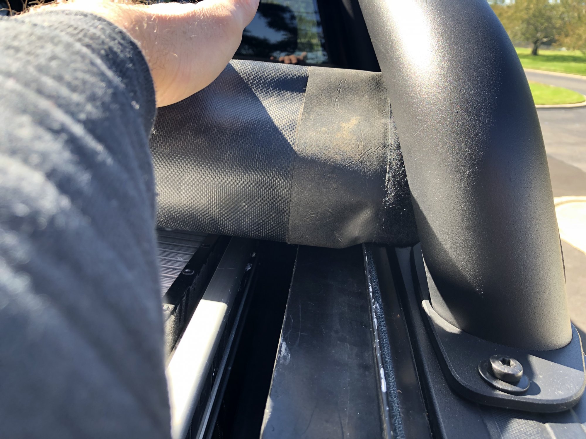

Hey guys I have the same sports bar and am having an issue finding a bed cover that isn’t stopped by the foward part of the sports bar during roll up. Does the one you have installed have any issues rolling up to the window if not can you forward the info on it ty
Edited by Toadtits

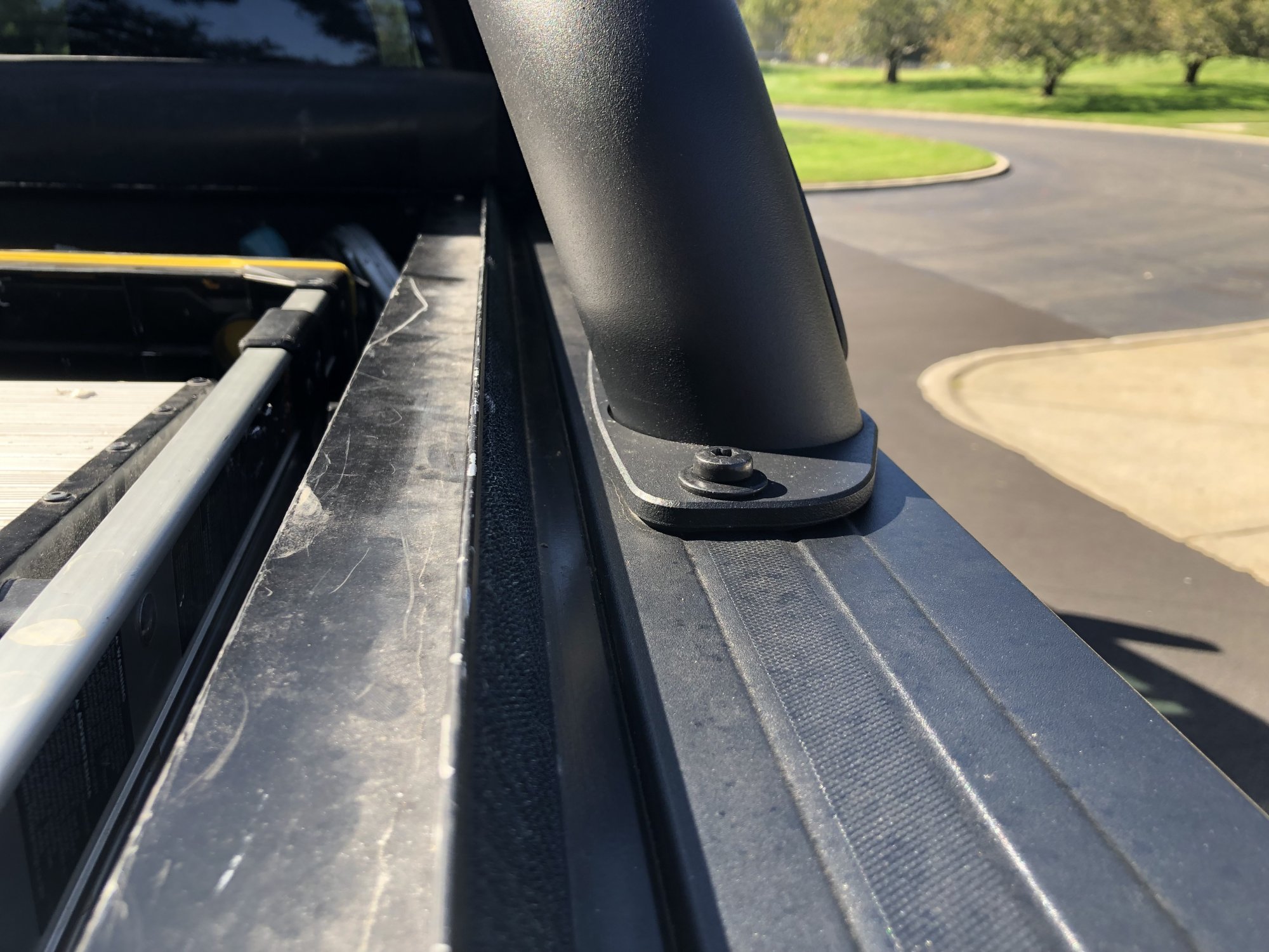

Also I had Chevy install mine and they cut off the foward bracket that grabs the bed rail and instead drilled and dropped bolt from the top of the rail instead of the side making a inside rail cover capable without having to modify the bed cover at all will send pics soon
