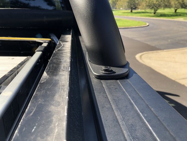

A few of the fitment issues I dealt with:
First, the rail needs to be cut to clearance around the roll bar, and OBVIOUSLY I'm not done yet, I'm going to paint the exposed metal and fill in the gap with silicone caulk.
Second, the front mounts of the roll bar interfere with the cover rails, but I loosened the bolts holding the bar down and clamped down real hard (actually I sat on the bar) and retightened the bolts after the rail was installed. If I were to do this again, I would wait to install the bar until I had both the bar and the cover, install the cover first, cutting the rails for the bar supports, also cutting the foam tape on the front mounts before doing the final install of both.
Third, the roll gets a little big to fit properly underneath the support bars. 551e5a22803df1a0a7b89bbd6f47f6f5.jpg01861fd6aebfda284f5f8b0c90142ee8.jpg8953d79c0a22716eafd7b23fbca30cce.jpg
The trick for the roll, I discovered, was to not roll it tightly, but to leave it loose so that I could squish it under the bar. Then it rolls up all the way no problems. I probably will only roll up the cover fully once or twice a year, mostly for firewood in the fall and hauling kids through the campground to the swimming hole, otherwise it'll stay shut. 7fa402fddea88b2d2708a06cddc23bb4.jpg
