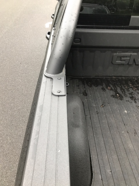

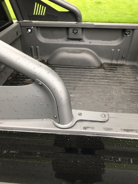

Thanks. I didn't disconnect the wire but did detach the bars. I just placed the bar sideways in the rear bed in as much as the wire would allow. I then used a roto-zip with a 3" metal cutting disc. I cut along the top of the bar (as opposed along the side that attached to the bracket) which enabled me to get a straight edge (rather than a little bit of the curve). It only took about 5min per side. It was a very quick process. I then used a grinding stone attachment on a Dremel to smooth it a bit. Then, I used the steel brush attachment to polish it further. Finally, I used satin black Krylon to paint the edge (wish I could have found grey). I haven't done it yet but I intend to drill one hole in each bracket straight down and attach it with a 1/4" wide, 1" long stainless steel bolt. Then, I'll be ready for the retrax. Thanks again. For anyone else wanting to do this....cutting the brackets is really a piece of cake.

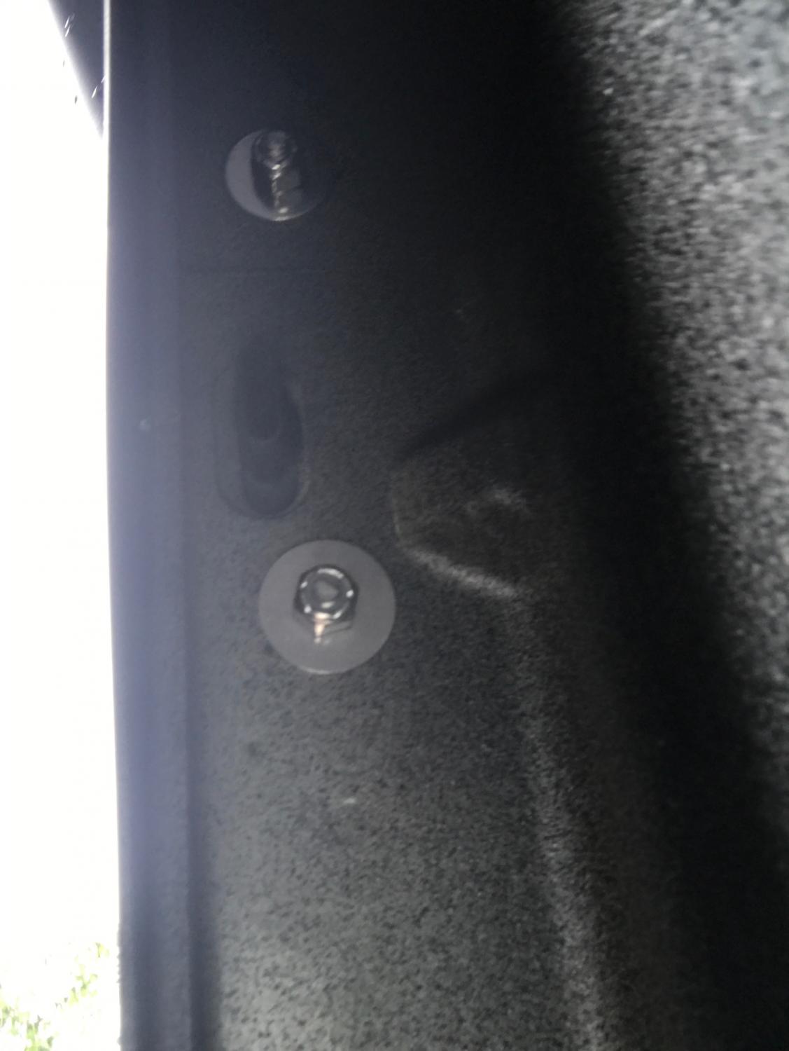

Yes..... I decided to put two in to each bar. 1/4" flat head top stainless steel screw. 1" long. Used a 1/4" steel drill bit. Went right though. Easy. The screw heads are same size as the ones on the "Sierra" shield. I spray painted them black. I used 1" stainless steel washer underneath with plastic locking nuts. I think it looks totally fine and matches everything else (like the screw heads that stick up behind the passenger side forward bracket. I can post a pick if you want. All good and very worth getting a nice bed cover....retrax for me.....

Hi Mudded..... I haven't installed the retrax yet. I will in the next week or two. But, The way I have seen others do it is to actually remount the sports bar on top of the retrax flange. Others have said this is no problem. Biggest issue of course is mounting the rails which was eliminated by cutting back the roll-bar lip. I will post pics when done. Thanks, AML
