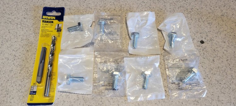

has anyone added the oem skid plates to a regular 2015 LT 4x4? these would be the same ones a z71 has... i found all the parts online... looks like for less than $150 you can have the same feature as a z71.
thoughts, anyone done this? am i missing anything?
(see attached picture)
