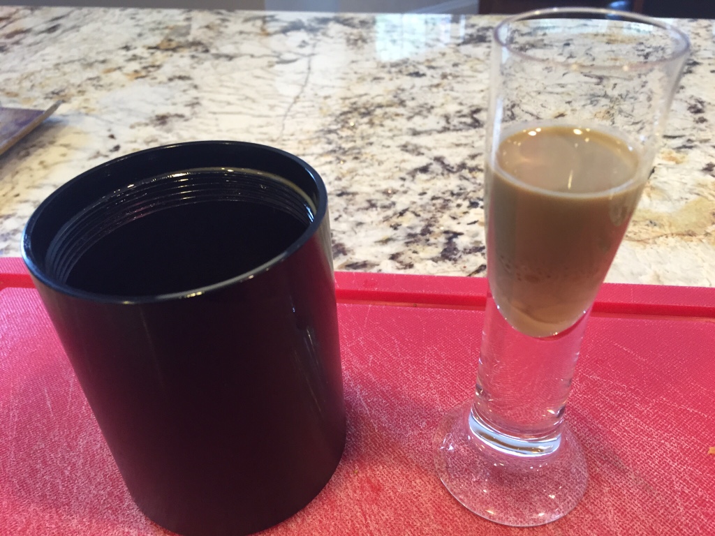

Few pics of the install on my truck. Turned out factory looking just as i had hoped. The clean side separator shipped separately for some reason so that's an install for another day.

waste of time typing this but here it goes: To simple for some. Put a catch can on and you drain oil out. Gee it would have gone in my intake to my valves and rings. Too much for some here. Especially on a DI engine!
My NON-DI 09 5.3 should have had one from the get go. Maybe then no clogged rings and oil burn because of gms poor engendering on the pvc and afm. To which they admitted by coming out with a too late fix. When we put my cc on we mopped out a lot of oil. I now drain oil out of the catch can. I went RX based on discussions with them.
