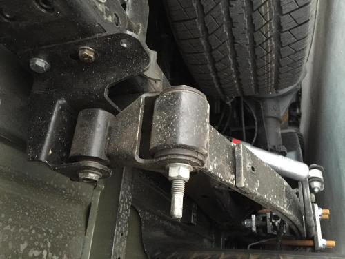

Ok so I am going crazy with the ride in my truck and the shop can't get it in till Friday. So today I jacked it up and it was setting on the bump stops before I raised it. I cut the bump stops off as much as I could and reinstalled the tire. Now when I lowered it back down it still seems like it is setting on them but driving it gets a slam noise over every bump. So when I have them instal the new energy suspension ultra low bump stops do they cut out the part hanging from the frame. It looks to me if that stayed on I would be in the same basic position with maybe 1/4" more clearance.
Seems to me the rear shackle only has one option for the rear drop which they say is 6"? Does that seem right?
Are you asking if 6" drop is the only option for the back? I have a 3" drop shackle....... Didn't really affect the ride IMO
Yes cut the welded bumpstop bracket off.
As far as I know here are the configurations for drops with a flip:
7" with stock shackles and stock backets
6" with 1" lift shackle and stock brackets (Most kits don't have this shackle)
5" with stock shackle and aftermarket bracket mounted in the highest location
4" with stock shackle and aftermarket bracket mounted in the lowest location
RT can probably correct me if I am wrong, but I don't think you can do 6" without a new shackle.
7" with stock shackles and stock brackets
That is correct.
