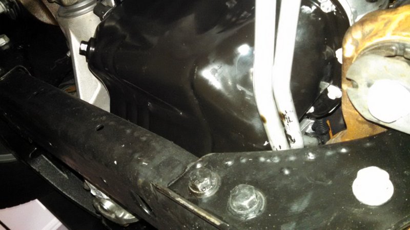

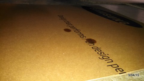

Hello All- Newbie here,
So bought my beautiful new Silverado loaded, Crew Cab, 4x4 after a lengthy process finding the right combo and making the right deal. The truck is primarily used to pull my 6k lb toy hauler. At about 3000 miles I noticed from one weekend to the next a drip or two of oil on the driveway. Since I recently had a leaker with my 2005 Silverado it didn't really concern me...about three weeks later and a 1000 mile round trip I noticed a slightly larger puddle. My initial thought was someone was messing with me...looked under the truck and three drips, 1 around the lower oil pan, 1 on the tranny housing and 1 on the cooler line. Couldn't believe it...took it in, 4 days of diagnosis led to them replacing the lower oil pan seal hoping it would fix the issue. A few weeks goes by and a trip up to the Eastern Sierras later I pulled the truck out of the driveway and again, leaking. Same drips, same spots. I had opened a case with GM, it remains open today. The truck is back at the dealer and now diagnosed with a cracked rear seal housing. Going on 1 week still not repaired...dealer is saying a few more days...I'm just ecstatic my $60k is now completely dismantled....left a message for my case worker Tuesday, no response....not sure how far I should push this. Thinking buyback....just want everyone to be aware, I took a hit on a 2013 Malibu they couldn't fix, not swallowing this one! Thoughts, experiences welcome...
Completely dismantled? Now that's going to the extreme. All they have out of it is the trans not a big deal, my 2012 had a oil leak at the rear seal and they had it for about 3-4 days and never had a problem with it till I got my 2015. No way your going to get a buy back just for this, don't sweat it its not a big deal.
Update, dealer now telling me it's a hairline crack in the block. Going to need to replace the engine. Dealer customer relations manager is recommending buyback to GM. Engineers coming out to inspect this week. I'll post as info is available.

I have a similar problem with my 3500. At 7500 miles I noticed oil spots in the driveway. The dealership was quick to diagnose the problem as a cross-threaded bolt. The diagnosis from the dealership was that the only resolution was to replace the engine because of the location of the both and how the cross threading occured.
They kicked the issue to GM tech support with the recommendation to replace the engine. The GM prescribed course of action from GM was to pull the engine and try to mill out the hole and insert a larger bolt. I called GM Customer care and have tried to get them involved with little luck so far. The issue is dragging on and I have the truck parked for fear of coming out to find a giant pool of oil under the truck after the bolt let go.

I too had a leak in my 2015 Silverado 3500 HD Duramax. First trip to the dealer for warranty repair they had to drop the transmission saying it was a rear seal. Without my truck for four days. Drove it home, next morning still leaking oil all over my garage floor. Back to the dealer, kept it all day, said it was not leaking just thought they hadn't wiped it very well after the repair. Back home sat for three days before I checked it, still leaking. Third time back to the dealer where they kept it about 4 days. Said it was the oil pan leaking. Looked like they either lowered the oil pan and put a "big" bead of sealer or just put the big bead of sealer without taking the pan off. After this is hasn't leaked. Was the real problem the oil pan in the first place? Who will really know. I was one additional trip back to the dealer before I was going to request a buy back.
I have read where many of the early 2015 Duramax diesel trucks have had leaks. There has to be a problem somewhere.
