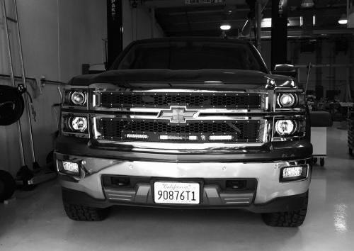

Happen to have a picture showing just the headlights on? With the install of the LED bulbs & ballast, are you still able to use the round covers on the headlamp assemblies?
You have to modify the cover. I used a heatgun to make a "bubble" so the bulb fits inside. It wasn't allowing me to use the covers. I'll try and get some pictures. This is on my brothers truck. If you have a GMC if all fits inside the headlight assembly lol

I went with The Retorfit Source Morimoto kit for my Silverado. The whole kit is very high quality compared to my old lights I purchased from DDM on old vehicles. Nice Braided lines and waterproof connectors. Ill post up again after I install but very impressed so far.
Ill plug Fondupots write up videos. Thats what got me to go with this kit. Its for a Sierra but looks the same just order the Silverado kit instead of Sierra.
