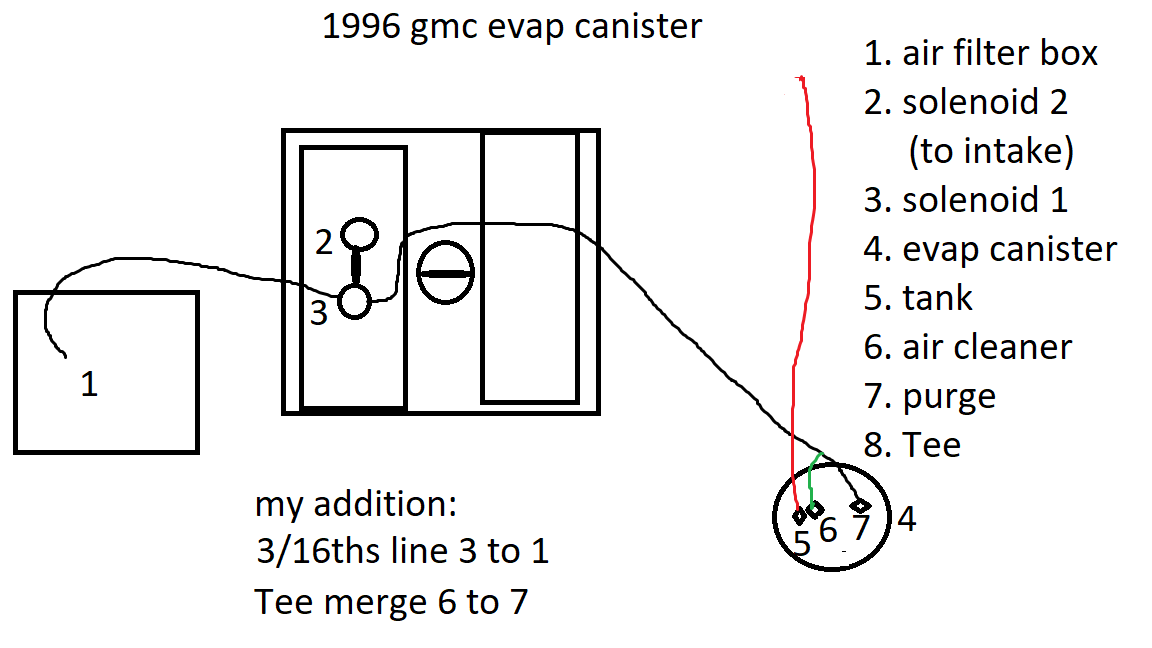

purge can
was looking over little things, found my truck has no purge solenoid destination.. just spewed to the air.
no attempt at all...ever. No plugged barbs on intake, nothing above throttle either.
I am glad my old gmc is all clean, new tank, pump good fuel cap.
This can be a real monster in my locale. Autumn and spring mostly.
So, I ran a line over to air box.. and might add a bunch of little clamps to the silly weak connections.
and here is my 365k mile scary monster going to a VA hospital. :)
volunteered to take my neighbor there for his new wheelchair.
Edited by barry G
canister final
no matter what goofy direction this opens and closes and storms its way around..
it is now fixed. I am certainly adding 2mpg solid to the mileage.
Is this goofiness on canadian built trucks only?
solenoid 1 (#3 in drawing) had an open line, and it was active. Dirt and dust in it. I am sure this had a 2 way direction in the wrong environment.
I am calling that the killer for now. I ran a line to airbox (#1)
The other one was #6 marked "air cleaner" on the canister. It had an ac delco cheap hard plastic plug that wiggled around .
I merged that with purge - #7. (it is where little green line is)
Edited by barry G

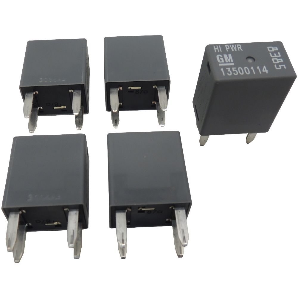

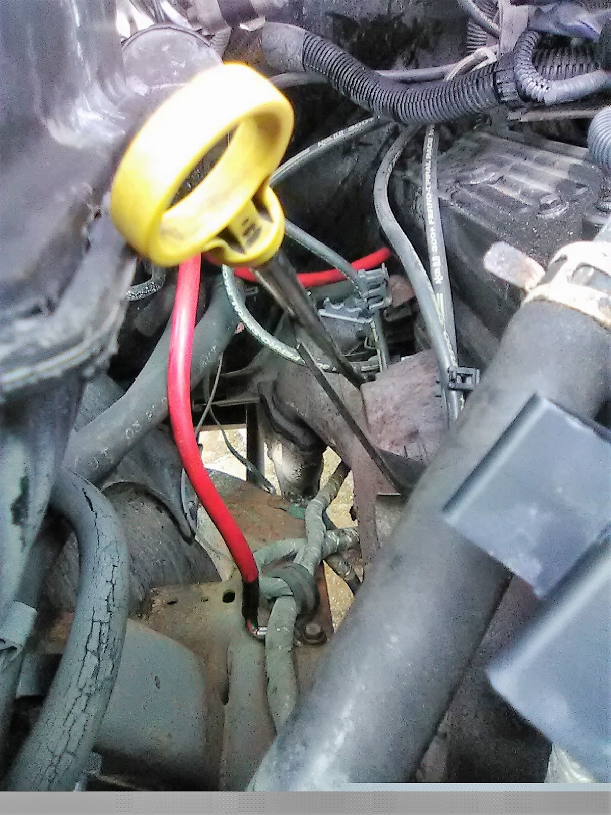

relays
it happened again this morning..
no fuel pump relay. I just leave the key on and cycle random.. I then know it going to start by the noise the pump makes.
reeling in some memories of the same dark time of year and the distant past..
I remembered power is thrown at fuse panels, then everything fights over it.. then they called that balanced. :)
so I browsed ebay and bought all the relays...so I can match up all of them.
I have mismatched and even different colors as of now..21 years can do a lot of things to a fuse box.
staying uniform is not much thought about.
these trucks twinned all the relays as photos show.
these are from unused fuse panels for the gmt400.
all brand new.
I opted for the taller denso kickers for the 5 pin. I have the short square fat version, some with no label..one is grey,one is black etc.
the four pin, I have had no trouble with...going to make them all the same anyway.
I finally deciphered a relay to be acting like a barometer.
not about wet or short circuits.. it relates to weather changes overnight.
I also dropped an incredible amount of amps for lighting circuit..and the new fuel pumps are of course more efficient.
you cannot make a relay come down, unless you trick it.
that is how my DRL relay survived... the LED swap is a different type of demand.
dropping amps is not the same as diode.. relays can't change easily to an amp drop.
this should do it.
the problem was so random I could not figure it out.. and then I realized the weather patterns at the root.
not cold or hot, not rain or dry snow...
the facts of barometer changing fast.
I can't wait to chuck the old relay in a dumpster. :)

But it was a blessing in a way.. the starter died, after whirling it over for half a minute.
the random no start condition was kicked in as well.
Terrible day for it. I was just four hours prior in orlando florida.. now under the 12F truck in an ice puddle dropping a starter.
I then finally found the elusive random no start as I slapped the old start on the parts counter..
cracked starter solenoid. It even gained iron dust. I have only seen this 3 times in 30 years.
it kept right on working. The random no start was just had to loop a ground, probably to arching the block, kept it from full fire, or fuel relay to full pump. One or the other, it never got both.
It needed perfect conditions to do the weirdness.
It is funny, I described it "like a relay that accepts air to a barometer change"
that was very close, my first guess.. but as it turned out, it was a solenoid with a whole lot more amps than a relay.
it has been doing this for about 2 years.

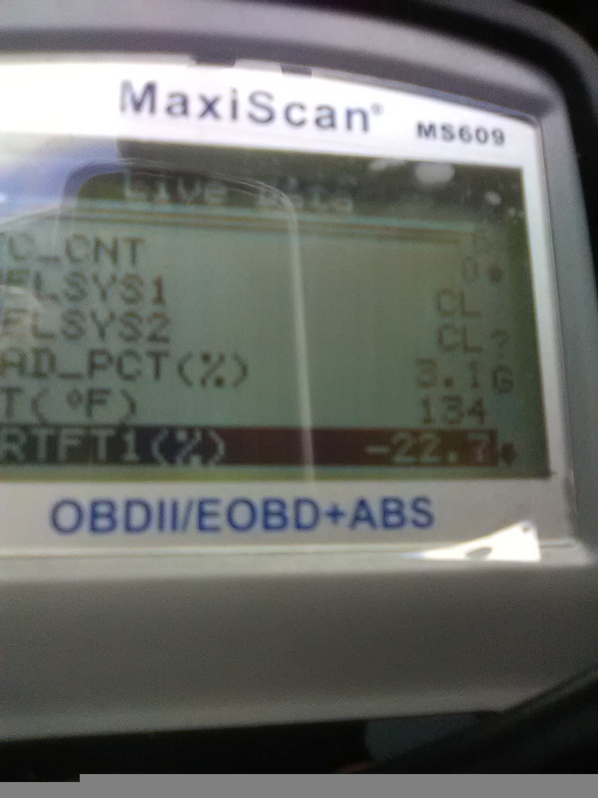

random hard start again this morning.
too cold.
counting on the gadgets wasn't enough.
random high trim almost flooded the cold start again this morning.
3 below at 7am a surge now to near 40 by 1pm.
Click image for larger version  Name: trim1.jpg Views: 1 Size: 340.3 KB ID: 1188021
the trim is nearly pegged counter acting a sticky FPR.

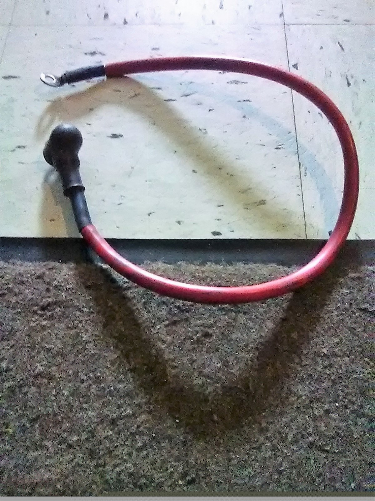

monster ground
first warm day since july, I decided to poke around and diagnose the random no start.
the turning off of dome lamp on dome lamp over ride helped gain a start.
So I beelined to engine to frame ground and chassis to frame ground.
very brittle.
both broken.
if something breaks once, you gotta go 100 times bigger to fix it. biggrin.gif
Click image for larger version  Name: subarustartercable.jpg Views: 1 Size: 509.8 KB ID: 1188104
I rummaged through my cable bin and grabbed my subaru starter cable.
two eyelets, high grade copper.. why not.
Click image for larger version  Name: monstergeround.jpg Views: 1 Size: 455.0 KB ID: 1188103 bolted into factory spot behind passenger head.. they even used a fancy brass looking nut on a stud.
it "un-ironically" shares a ground coming from distributor.
I will wager random no start is fixed.
the camaro door dinger is super smooth.. only thing to notice thus far.
I bolted into a spot about ten inches from original
I have confessed, as insanity pursues it, that I am a strange nuclear problem with my hands.
No joke:
within seconds of touching the broken ground, my towns power went out.
spooky. Ghostly.... mythological.
Edited by barry G

well the ground fixed it. back to the feisty cold starts that keep me liking this truck alot.
one of the things I had been nearly boasting of for 3 years now.. the cold starts are extremely impressive.
21 below whatever..ice storms, soaking sopping wet, frozen, hurricane, blizzard.. nothing matters.
it starts. It starts big. :thumbs:
it must have been using a header zap off motor mount to eventually snap a start.
the sad thing is.. I have done this 3 times to my GM v8. my first with my own truck. The rest was cars.
that cheap ribbon ground coming from engine.
the last problem was not hot enough for the engine, I had plenty of heat in the cabin however.
That gained a simple fix.
removing air lid and snapping it back down with a gap raises IAT with some engine heat. this truck was pegged at 30F on the IAT for months.
finally got coolant moving around. this 305 can stay air cooled for weeks in maine. Barely opening thermostat.... for weeks.
now that the ground is frozen, air temps do not help much. Truck has to be arctic proof. It has to use its own heat to raise intake temps.
Edited by barry G

I also found the mystery of the engine ground? it was not even old..
something like a squirrel or chipmunk gnawed at it...and it was indeed the autumn.
maine drops its first cold bombs in september/october. They love my truck.
The ionization odors are like burnt wal nuts. It must have got a taste for the copper ribbon.
the new shielded cable only made the perfect cold starts even bigger.
