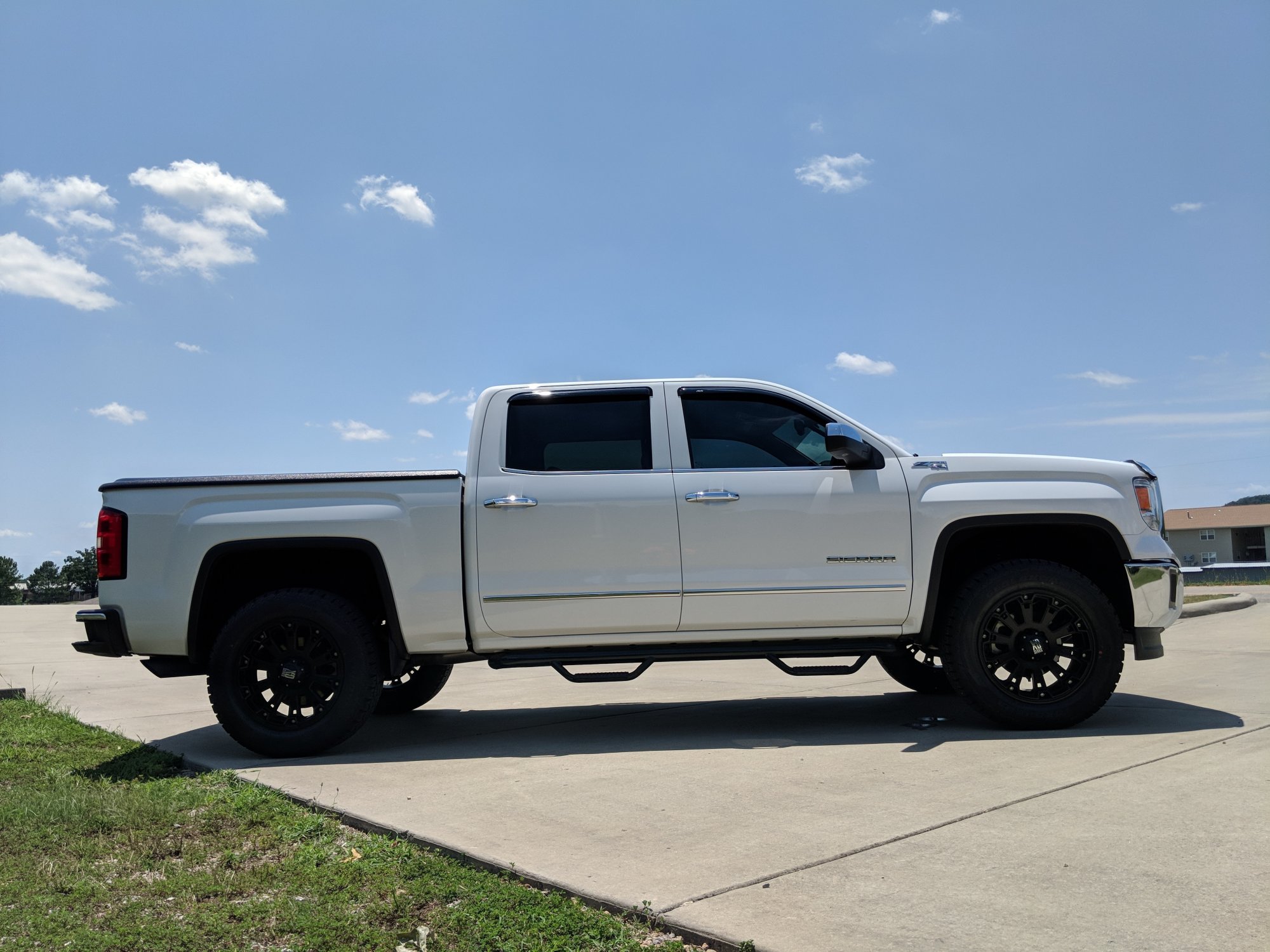

As promised, here's a before and after of the finished product:
truck%20level%20and%20tires_zpsmjvjp5ix.
Ignore the crappy "photoshopping" around the truck.  I was trying to hide/cut out other vehicles and items to protect others' privacy.  As  for the truck, I have the 5100's set to the 2nd highest setting (1 down from the highest setting).  The tires are 275/70/R18's.  I was worried about how the load range E tires would feel on the road, but the truck drives great.  And I can't explain why or how, but my steering loosened back up after these tires went on and the popping noise when steering issue went away.  The only explanation I have is that the noise and tightness had something to do with the angle of the tierods and the new tires adjusted that angle just enough to make a difference.  In theory I wouldn't think the tires could have an effect on the angle given this set up, but I don't know how else to explain it.  Overall though I'm thrilled with how the truck looks now and how it drives.

Been running my Bilstein 5100's for over a year now and I have been very happy with them. Recently up graded to LT275 60R20 Yokohama Geolandar AT G015 tires. Little over an inch rake, but I think the stance is prefect.

Looks great! I plan the same thing for mine.

Thanks man.  Nice you will love it!  It's hard to tell in the 2nd photo but I was trying to maintain some of the forward rake because I still plan to haul and tow some with this truck.  But after the level and tires I raised the front almost 3 inches (tires plus leveling shocks) and the rear about 1 inch (from the tires only).

That's exactly what I'm looking for. I still need rake for hauling the boat ect.

I think I have about 1” of fall from rear to front now.  Before the level it was about 3 inches
