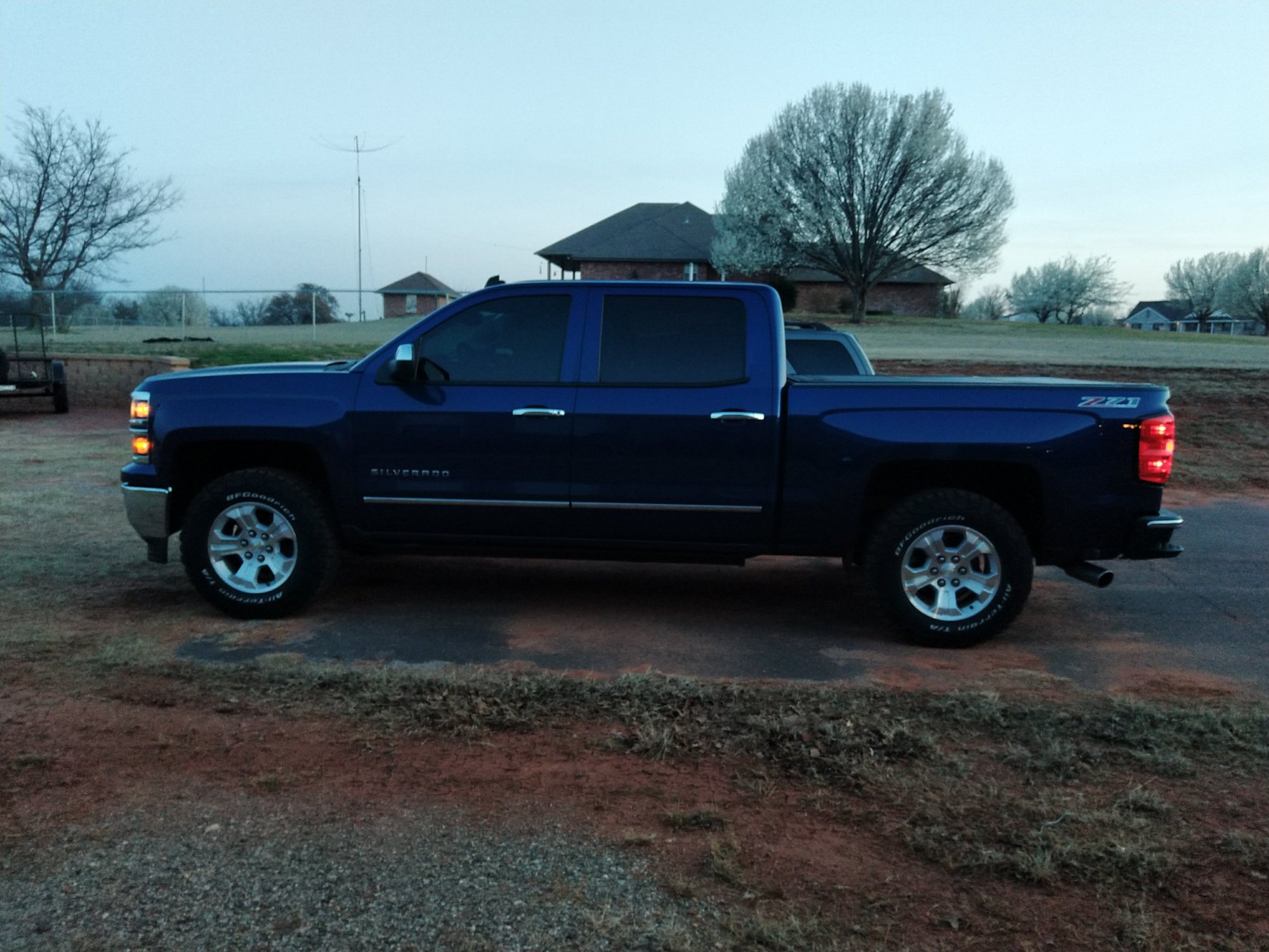

Dtz7116 Posted April 10, 2018 Share Posted April 10, 2018 (edited) On 2018-03-19 at 9:56 AM, Fasthotrod said: I run BFG KO2's in 275/70R18. I put them on long before I ever put the Bilstein shocks up front. I only had minor rubbing on the inner fender liner, and only at full lock when turning. Since putting on the Bilstein shocks at the highest setting, I've not had that problem at all. Kinda hard to see it as I took the picture at dusk after installing the shocks... but it sits pretty level. I might pop a 1" lift block in the rear to give it a little rake, but so far it's not been bad at all. Shocks are a bit more stiff than the Ranchos, but not in a bad way. Turns feel better without a lot of body roll, bumps are more firm and it doesn't take long to settle down after a large dip. Do you have any other pictures? I will be installing my 5100 next week. Your tire size is what I've been looking at, just not sure yet. Thanks! Edited April 10, 2018 by Dtz7116 Quote Link to comment Share on other sites More sharing options...
