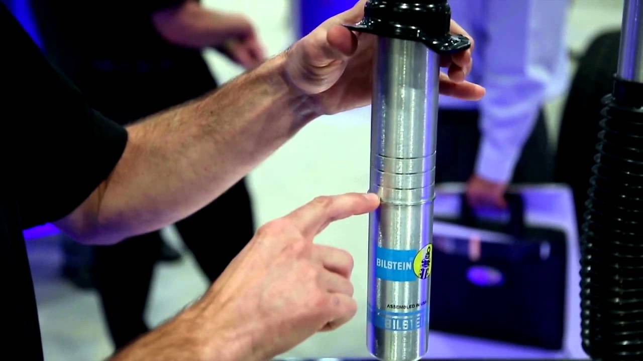

I bought the shocks through Autoanything.com and took them with me. The shocks can be adjusted up to 1.87" i believe in the front. I left mine stock height since I already had a level up front.

The different groves in the shock body is what gives you the lift, hence "ride height adjustable". The fronts are the only ones adjustable. The rear 5100's are designed to accommodate 1" lift. If you cane change your own oil you can replace the rears. An extra set of hands are handy to compress the shock while installing the bottom bolt, but not required.

Doesn't matter which setting all 3 ride about the same. I have mine in highest setting rides no different than one I drove that was on middle setting. I spoke at length with bilstein engineers on the phone regarding this. Basically the reason the highest setting doesn't 100% level the truck but it's the max they could design without adversely affecting the ride quality. They are designed so all 3 setting produce the same ride. The certified internet Google trained mechanics may say otherwise but I went straight to the source. Also have a truck right down the road set in the middle setting if I put you I either one you'd never know they are different settings other than a bit more rake on one of em.

The new 5160 Rear Reservoir Shocks are now released & in stock and shipping! They are 1.5" longer than the 5100 rear shock and will accommodate up to a 2.5" rear lift block!
