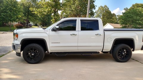

Finally got the front Bilsteins installed. Went pretty well except for the high dollar pos spring compressor from autozone. Had to go rent the cheap version from O'Reillys and that did the trick. I removed the rough country 2.5 level lift and installed the Bilstein 5100 adjustable shocks set on the max setting. Quick test drive felt good need some more miles on them to make a real determination on how the ride is, but so far so good. RC level /lift was 38.5". After the Bilstein 5100's 38.5". Now just need to get an alignment.

Leveled it out son! NICE I went with the lower setting didn't have the balls for full extension left me with slight rake......I can live with that!

Since it previously had the Rough country 2.5 level/lift, I knew I wanted full extension.

I'm surprised you got the same height out of the bilsteins as the 2.5" RC. I have the 2.5" RC in mine now and have a pair of bilsteins, but wasn't sure what I was going to do as I do not want to lose any lift height, plus I need to clearance for my tires.
