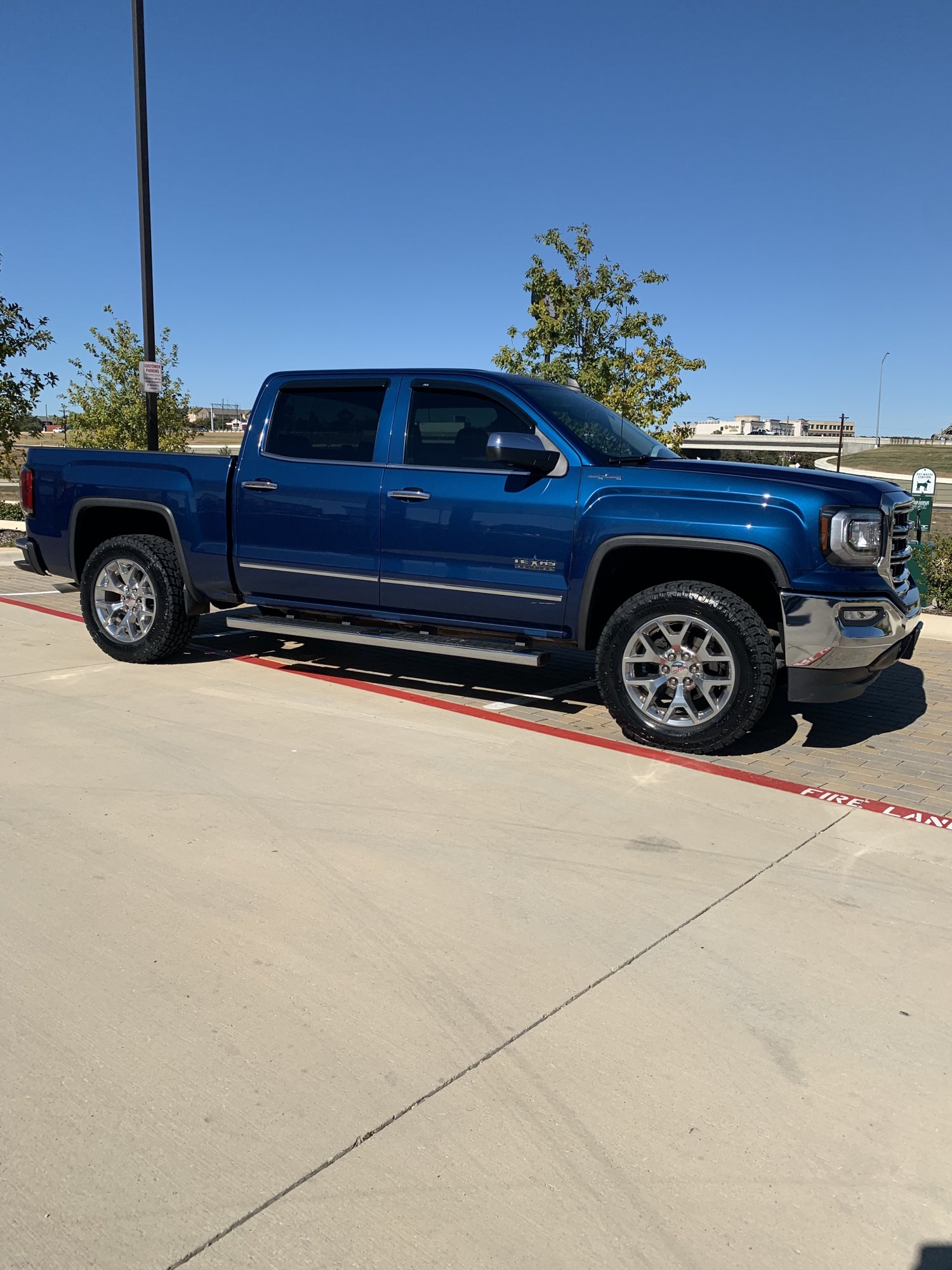

Well obviously I was speaking about tire size. I have a 2017 GMC Sierra 1500 4X4 with factory 20's. I'm going to put the Bilstein 5100's all the way around and put the front adjustable shocks on the third or 4th notch. The factory tires 275/55/R20 as ppl may know measure like 31.9 x 10.8. 285/60/R20 should measure abound   33.5 x 11.2.... I know from reading that 275/60/R20 will not rub and they measure 33" x 10.8"..... Just curious if anyone has put the 5100's on and used a 285/60/R20?
All I can add is my 275/60r20 did not run in 20x9 +24 offset, but there wasn't much room. I lifted the front 1.4", 1.85" lift will not have more clearance either.
They will definitely rub with 1" spacers as now I have 285/70r17 tires on 17x8.5 wheels, 0 offset and even though they're shorter (32.7 vs 33) they rubbed my mud flaps slightly until I trimmed them. No mud flaps would give me about .25" more clearance but I'm not going to run 0 offset wheels without them and throw rocks at my doors all day.
Finally got my truck done! 5100's all the way around and I ended up going 285/60/R20 which is 33.5" x 11.4" tire on the factory rim. There is a slight run at full tilt when making a u turn or cutting it real hard, other than that the truck rides great and looks great.

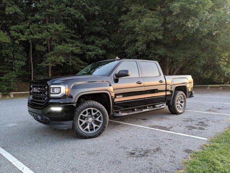

Installed everything myself. These fronts were a b***h. Removed UCA, steering, sway bar, just to fit. Ball Joint was a pain to separate from the knuckle. But it's beautiful.
Discount Tire price match walmart for a good deal on 295 55 20
Rubs on full lock
5100s all around
Nice set up! Which height on the front did you do?
