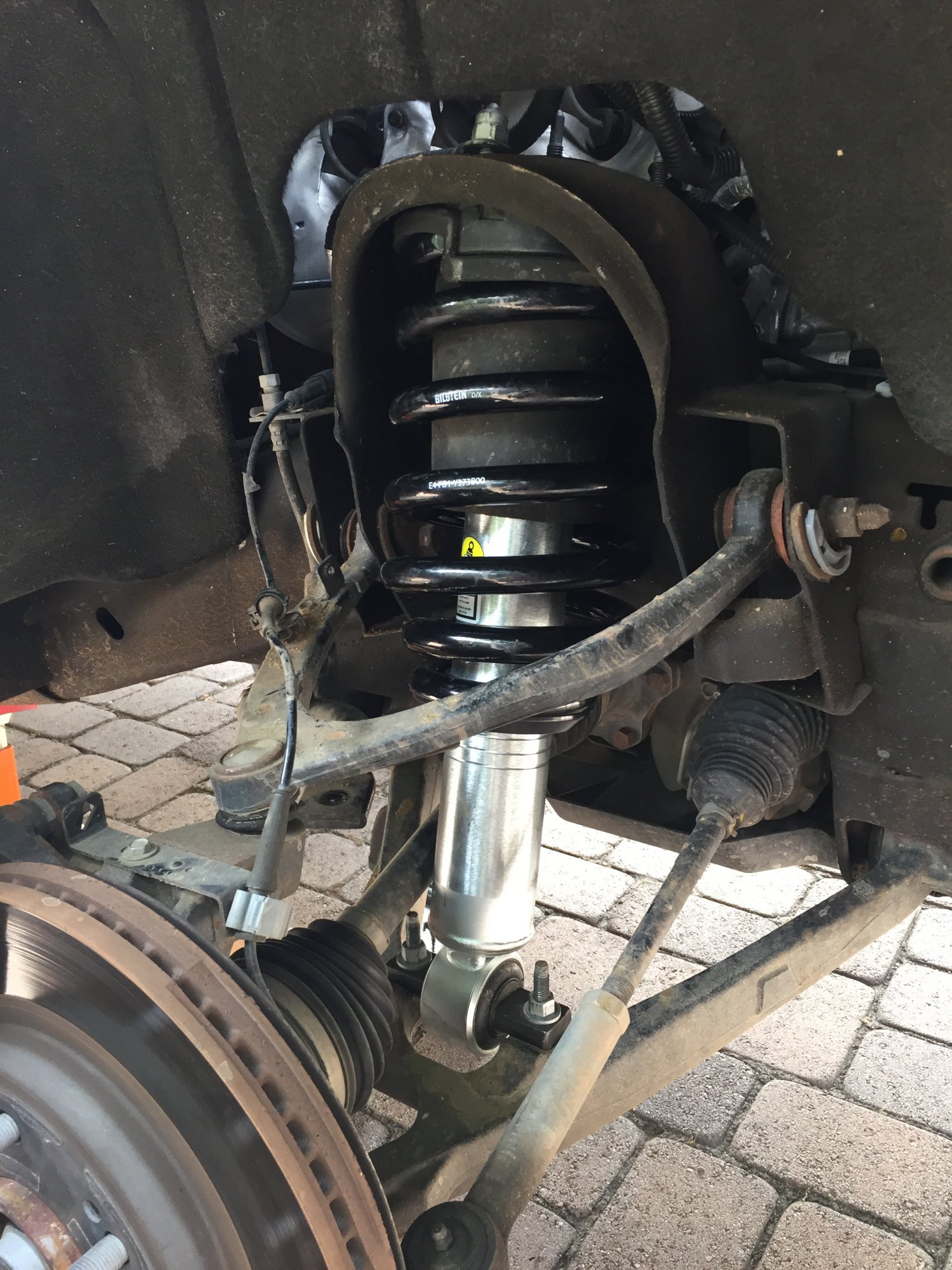

What's your measurement from the center of your wheels to the bottom of the fender liner front and rear? Center of the wheel measurement shouldn't be affected by wheel or tire sizes.
I don't have the instructions anymore but was wondering if it's possible the guy who assembled my 6112s compressed the springs too much with the nut on the top of the shock hat preloading the springs and reducing the front ride height. Just a thought.

Post up some pictures of how many of the snap ring grooves are showing on your shocks. That should let us know what height you are set at.
It’s definitely on the top position.

Hmmm ya that definitely looks correct. Could it be somehow that your suspension is binding up? I see in the pic your suspension should be at full droop (assuming there is no jack under the LCA in pic) but it looks as though your UCA is not hitting the droop stop...? I looked at my spring p/n and its the exact same as yours.

There's something strange going on and I might have to do some research before digging in. My passenger side front is just over 23" from center of wheel to the bottom of the trim and the rear is 24.5" so less than 1.5" difference. Driver's rear is 25.25" and front is roughly 22.75", maybe closer to 23" but still under. Passenger side has the front to rear height difference I had expected. I was under the truck looking at the rears to see why there might be 3/4" difference from side to side but I don't see anything. Blocks have the thicker parts to the rear on both sides. No visible gaps meaning something wasn't put together right. The nuts on the front shock shafts both look to have a very similar amount of thread showing but I was having a hard time getting close enough to get a good measurement with them in the engine bay.
