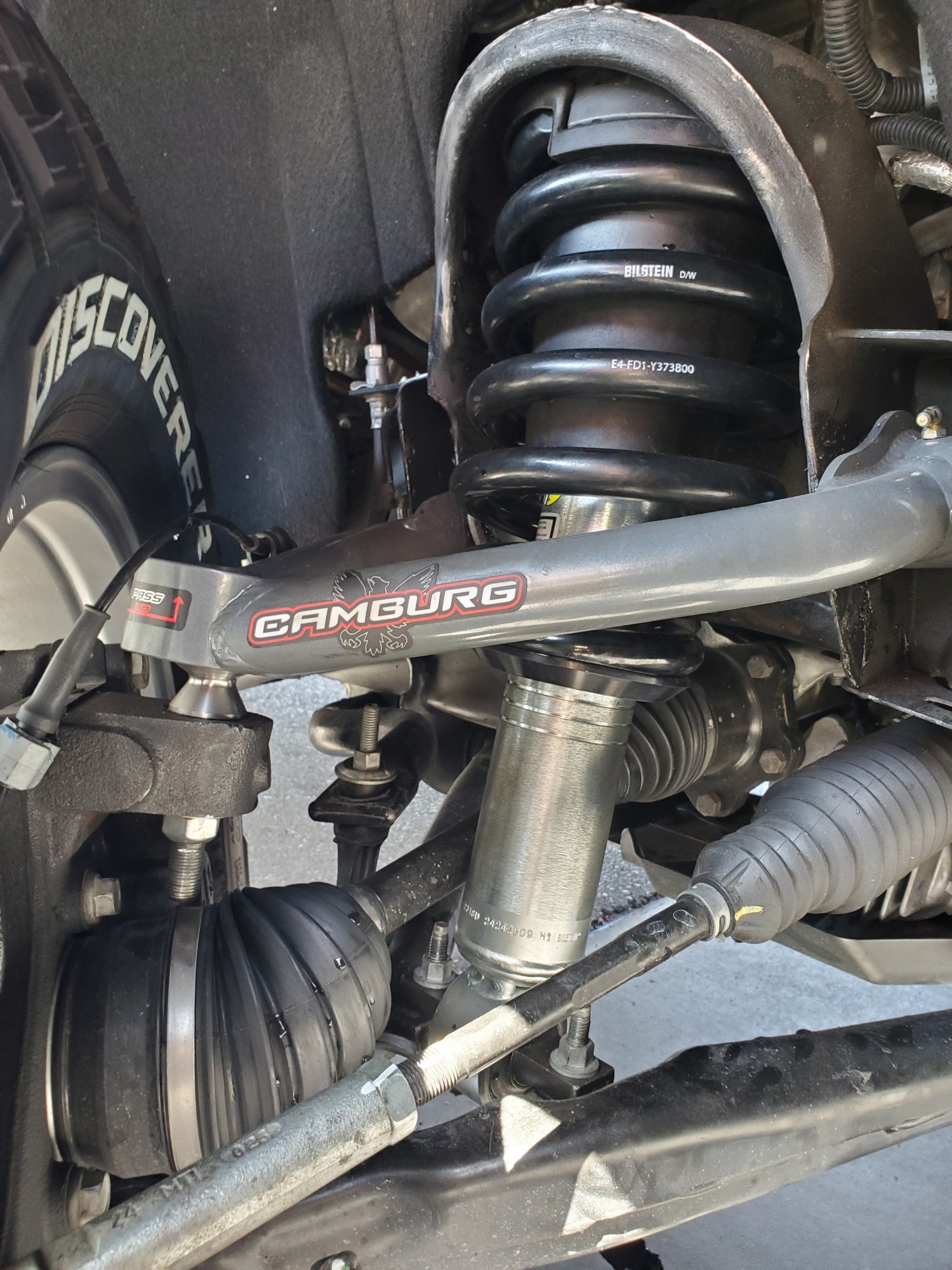

So, finally installed my 5100’s up front so I have them all the way around now. The truck definitely rides more planted now and handles bumps and potholes and rough roads a lot better. I chose to put the ride height at the 2nd setting which says 3/4” avg lift. I think that’s right about what I got, at least between that and an inch. And I wasn’t looking for much. Never really been interested in lifting or leveling and I don’t mind the rake usually because I haul a big ATV or tow multiples on a trailer. but it seems like the gm trucks have more than others. So before I had just over 3” of rake, and now I have just under 2-1/4”.
One thing I definitely noticed tho is that the steering really tightened up. I did an alignment at the same time and that’s right on, but when I’m at full lock left or right, I also noticed the front of the tires are rubbing on my UCA’s now and didn’t before. And this isn’t all that much lift.
So my question is: Is that normal, and to be expected? And is that gonna cause problems for the UCA’s/ tires in the long term? If so I’m probly gonna remove these and drop it back down to factory height cuz I already don’t like the way the steering feels, and to do damage over 3/4” front end lift isn’t worth it to me.
Thanks for any info, peeps!
