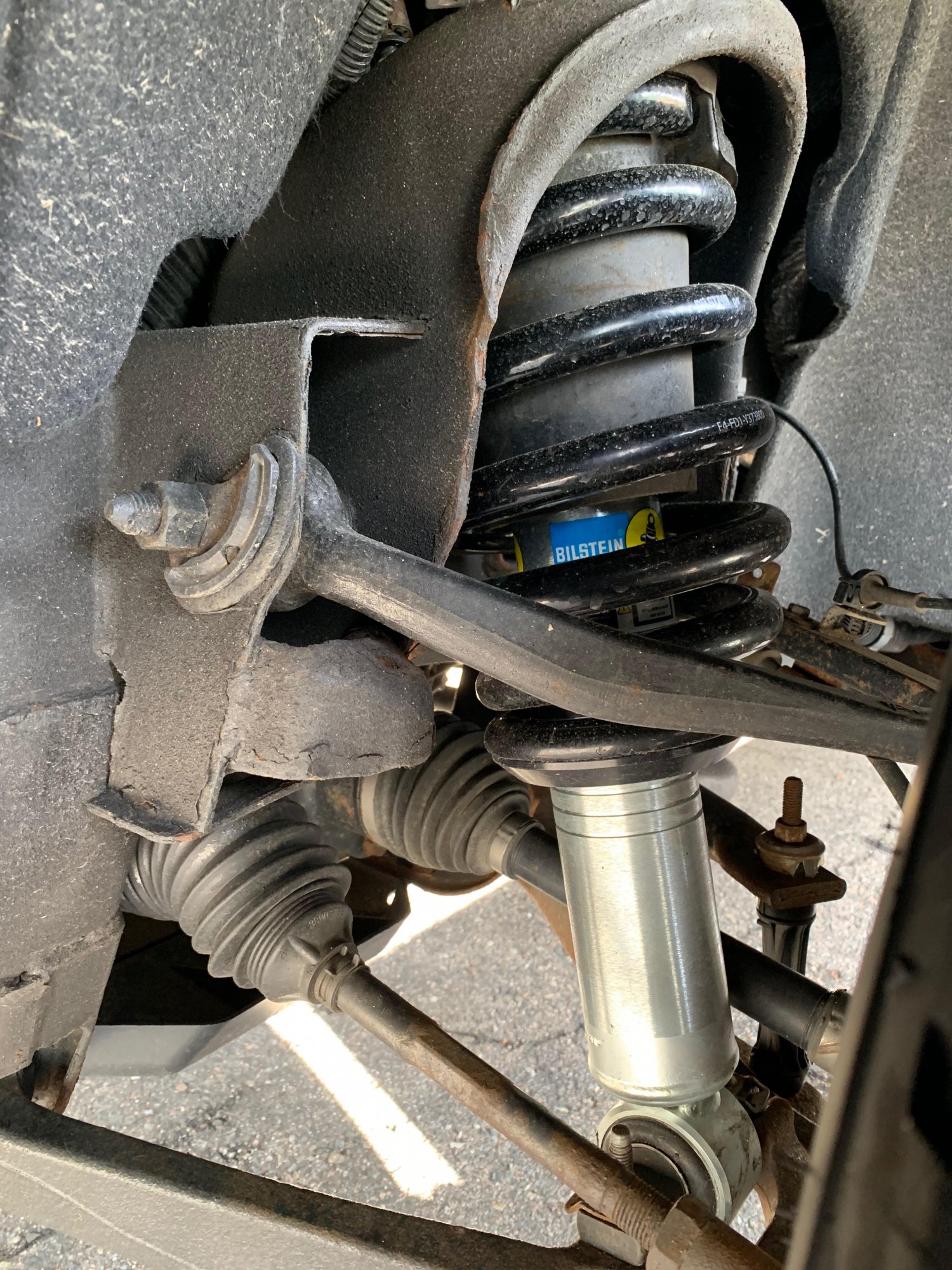

There are a couple pics where you can see the ring settings exposed. I know you have 5100, but scroll down a bit on 2014-2018 mod thread and click 6112 install or toggle back a page on this thread and you'll see a thread link. 4th setting should show 3 rings exposed below collar. 3rd setting should show 2 rings.
You should be able to turn your front wheel out and squat down in front of tire on driver side and see the setting with flashlight or phone. No boot on the front that I'm aware of.

Ok so I effed up with prior measurement. Parked her flat and here's what I got.
Have 3 inches of rake. Ring looks to be on top setting. What am I missing? 9a2a955c0def25dfc77b8b43585af96f.jpg983a7ef3c0c7e56279a8731198ec00c2.jpg7ba773a010acfd8a4047b208acebb67c.jpg

I won't have my truck back for a few days, but I have my fronts at the 3rd setting (4th being the highest) and a 2" rear block.  I don't have as much rake as you.  Seems like your fronts are at the stock setting, maybe 2nd.
