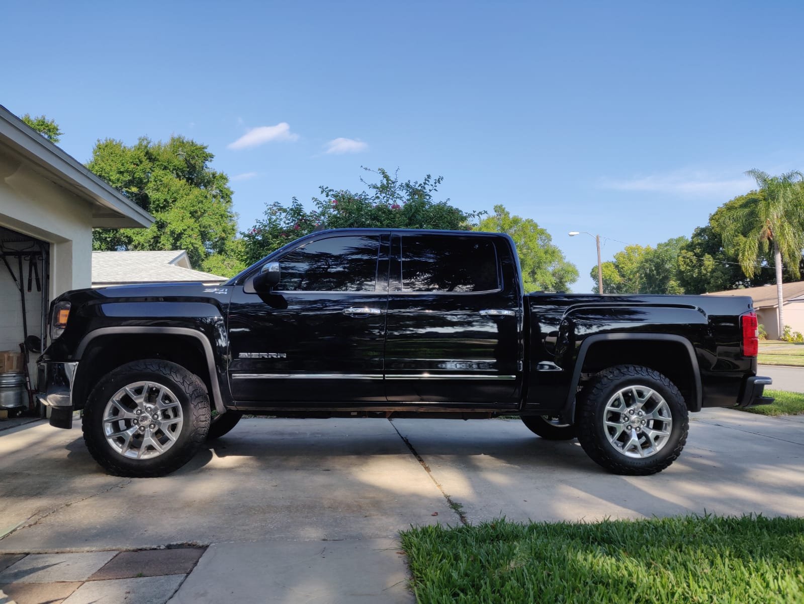

No trimming with that tire? I'm surprised because you really boosted the total circum. from stock of 100.2 up to 107". Thats a lot. As mentioned , 275/60/20 only increases circum. from 100.2" to 103.6".  In your case the outer sidewall + inner maintains same position with stock offset and you simply went higher. The tires I'm looking at are 33" high.
In addition that's a 10 ply tire with significant weight increase over stock. I want to say about 58# vs Goodyear LS2 around 40# which is P tire. I'd have to think that is a noticeable change?  Thanks again for the info.
The only thing that rubbed was the carpet liner which I tied back with some zipties. My truck came with the aluminum control arms and have not noticed any issues. To be honest I didn't notice a big difference lugging around more rotating weight, either but should probably mention I have a blackbear tune as well.  I ended up w/the BFGs mostly due to the fact they were the lightest AT tire I could find in that size, plus 4WP had a special during xmas a few years go, so it was a no-brainer.
Attaching some pix for reference.

Great looking Sierra Dub.
Then again I may be biased LOL

Thanks for the info and pics. Truck looks great.
