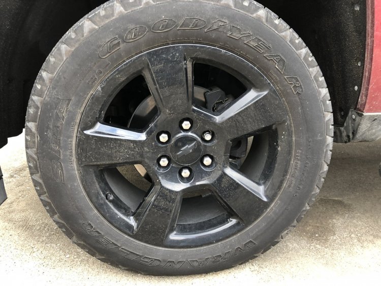

How do I find out what my rim is, as far as offset? factory 20” rim.
Those are OEM wheels that came with the truck? What year is your Truck? If that's a late model 1500, the 20" OEM rim measures 20x9 with a +27mm Offset.
