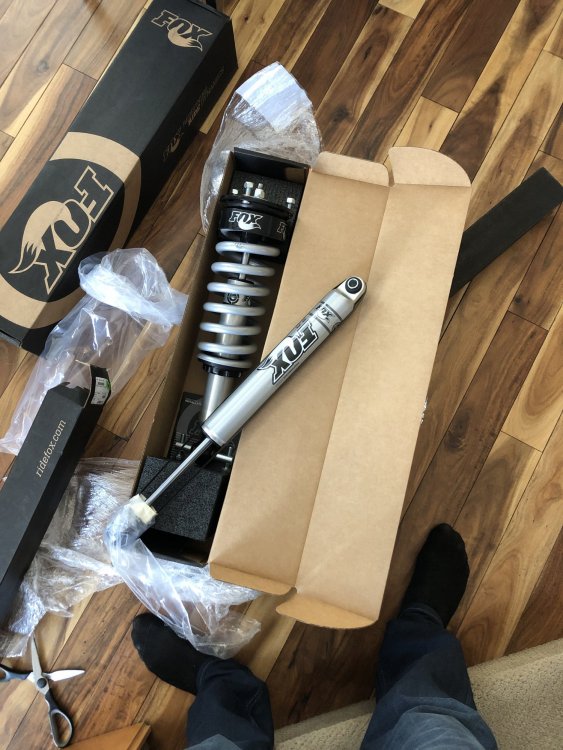

Hey guys, I’m a newbie to the forum but thought I’d post my shock setup. Recently just changed my magneride to Fox 2.0 front and back. I have the front coilover adjusted to 2” and have a 1/2” spacer on top of the coilover assembly.
