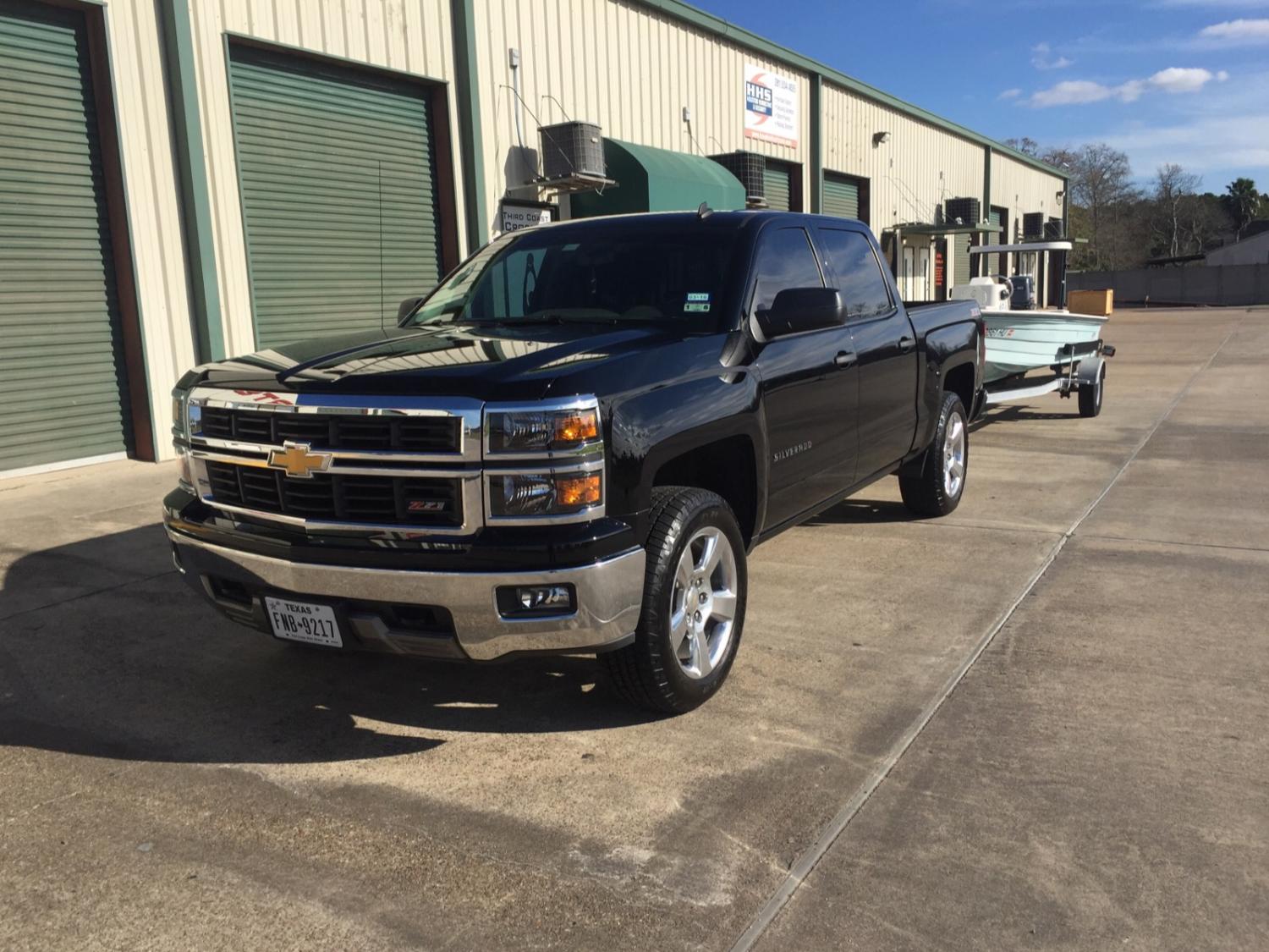

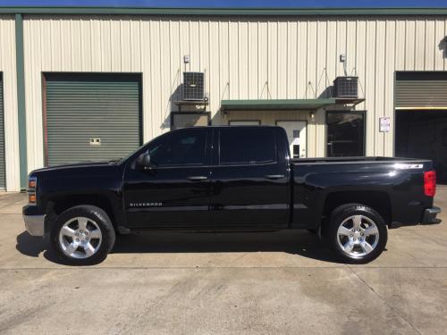

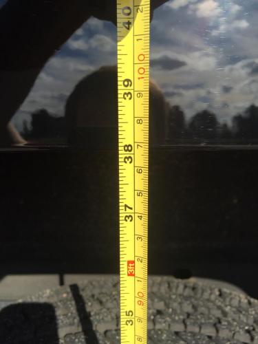

I'm no photographer, but I tried to get some good pics. As you can see, a slight rake. I also included a picture of the front end angle, seeing that most people are curious about that as well. For being the top setting, it barely changed the angle at all. The steering feels even more comfortable than before. Next I'll try to put some weight in the bed to see how far down it goes. I seldom tow or carry large loads, but it would be nice to know!

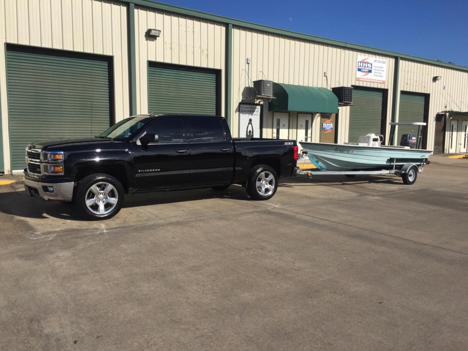

Got some pics with the boat attached. 37.75" in front, 38.0625" in back. That's still 5/16" of rake. Granted, if I loaded the bed down more, or put a heavier trailer on, I'd probably end up slightly nose high. I kind of anticipated that being a possibility, in which case I want to look into getting the Roadmaster Active Suspension. It's like add a leaf, but helps handling whether you have a trailer/loaded bed or not, plus you don't have to take anything apart... Worth the research.
