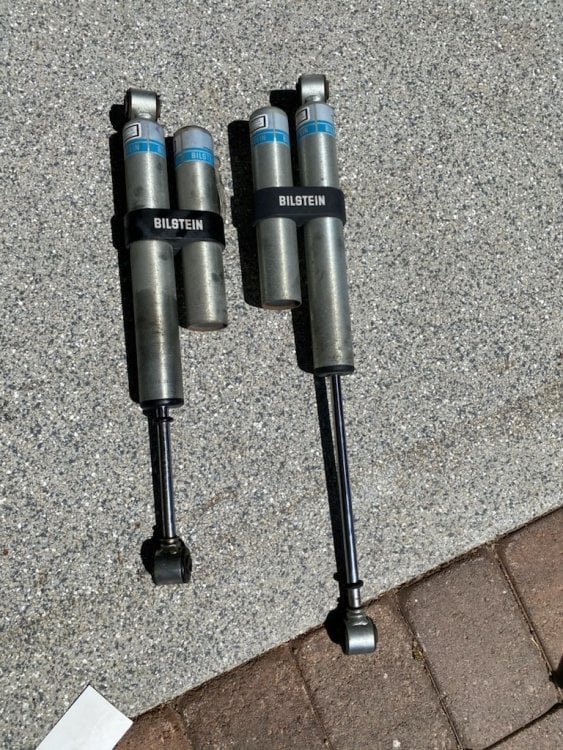

So I raise the shock perch to the third highest setting over the weekend and I'm now sitting at just under 38 in on both sides, and at 40 in the rear with Cooper AT3 275 70 r18's (39psi)
So then drove from Dallas to Houston and before I even got halfway there I literally found myself getting nauseous from the vibrations as I feel almost everything as I drive the truck certainly feels more planted when going down a country road then on the second setting but hit any kind of bump or expansion joint on a bridge and the impact is enough to make the headlight Shake, music playing over an SD card pauses for 3 seconds, like back in the day when you hit a bump in your CD player with skip.
I'm not sure what to do at this point as the second lowest setting does not provide enough rebound but the 3rd setting seems as harsh as the fourth. The front end of the truck literally bunny hops going over a Walmart speed bump at 5 miles an hour.
Is anyone else struggled with finding a happy medium between the 2nd and 3rd snap ring perch's?
I've also noticed that the front driver side is now anywhere between a quarter and a half inch lower than the passenger side

Zasker, I guess I’ll find out if I have the same thing. I’ve had my truck on the 2nd ring from bottom for the last 1500 miles. I pulled them yesterday and just picked up the springs after having a shop move it to the 2nd highest setting. Your experience has me a little freaked out!

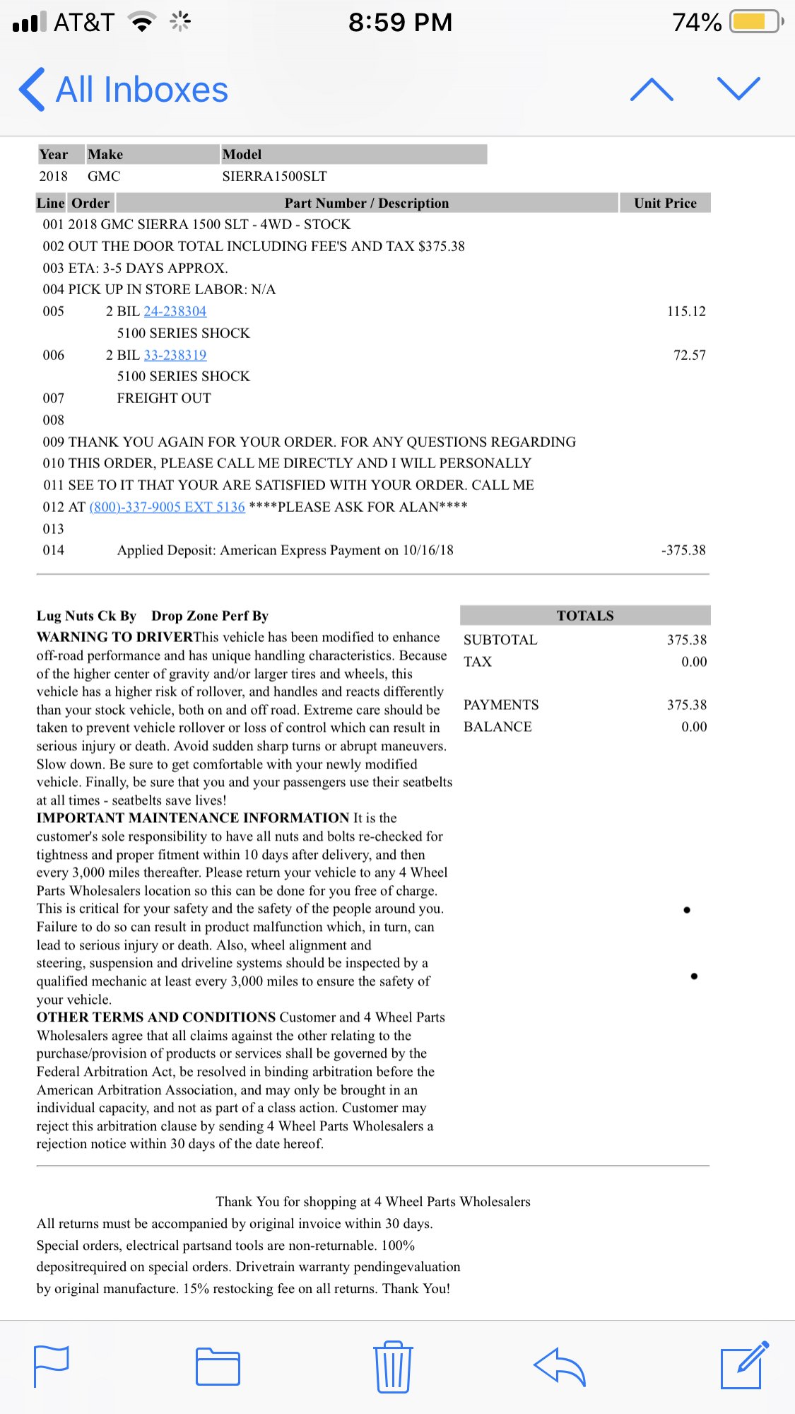

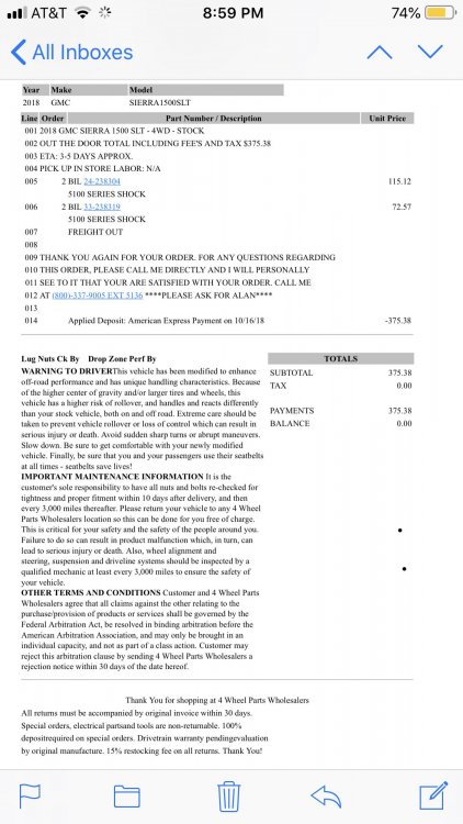

Oh, also I mis-spoke earlier about the cost of the 5100’s ...
4 wheel parts invoice enclosed...

I have almost and identical set up to you except I'm running the Cooper 275 70 r18 and I'm curious if you like the handling I just adjusted my bilsteins from the second to the bottom to the 3rd setting and driving to Houston yesterday I found myself getting carsick from the constant vibration it just seems like setting to is too soft and there's not enough rebound in setting 3 it is a brutal ride
Sent from my SM-G965U using Tapatalk
I have had 3 rigs with 5100's all of them on the 3rd setting. I tow a boat alot or I'd do the 4th. The ride is awesome from the 5100's! I would say something is wrong if you notice a big difference in ride between the 2nd and 3rd notch.
