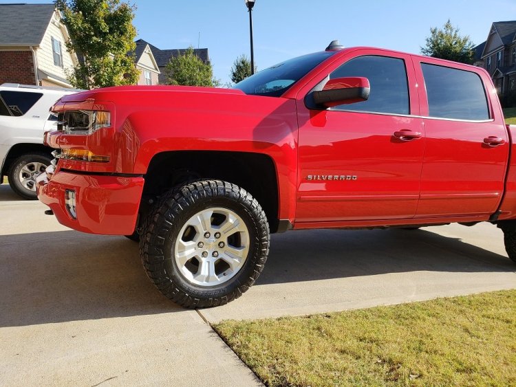

46 minutes ago, SquireSCA said:
Stock wheels, with Ridgegrappler 285/65/r18 on them
Found this on their website. I would call and confirm with them about wheel figment before ordering the kit if you do decided to pull the trigger.  This is their leveling/control arm combo kit but it uses the same control arms.

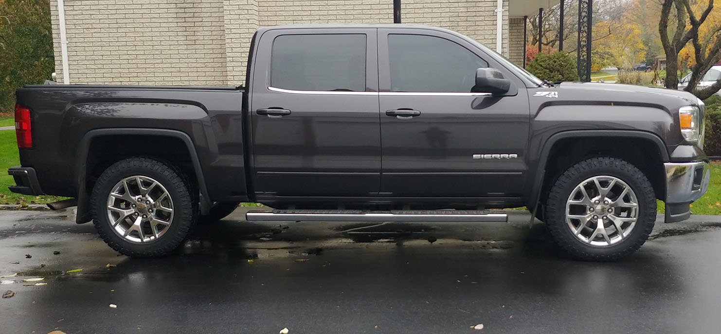

Here is our three week old Sierra 1500 SLT
My GOALS:
- Custom wheels to improve appearance.
- Maintain or Improve factory ride comfort.
- A simple “proven” and effective lift solution which was a reasonable cost.much.
- Crowd Favorite ...something the majority of reviewers agreed was a great upgrade.
- Must Have is a snow rated a/t tire for our mountain passes here in Oregon or Jackson Wyoming.
Simple:
I just didn’t want a hassle, or multiple shop visits. So a plug-n-play solution
Here’s what I did:
20” x 9” Fuel wheels to help fill the fender wells and dress up (a plain looking) truck. Very conservative custom look.
275x65x20 BFG KO2 tires
quiet, good ride, proven respected tire with a snowflake symbol (indicating snow rated)
Cost wheels and tires:
(Discount Tire - $2185 with rebate coupons)
Bilstein 5100 (adjustable front) shocks
(height set one click from the top setting) set of four shocks $345 + install cost
Result:
*Better Ride
*Improved Handling
*Taller stance
*Customized appearance
Am super happy with end result.
This is is a temporary truck for me. I will drive 12 months and donate to my daughter ...
Note:
this is a 2018 SLT Sierra 1500 with a “Denali-look” grill installed by dealer and front bumper vinyl wrapped (in black) $300 for wrap
i hope hope this helps somebody :) who’s looking for ideas. This is about as simple and conservative + proven as you can get.
Would love to have Terra’s on there, with their amazing look (trail?)... have owned them before and loved the look! But I need a highway distance “ride” for those occasional 7 hour+ drive/days.”
note: actual final stance is a slight rake with rear higher. This stance appears level, but actual truck stance is slightly lifted in rear.
Result: quiet riding BFG’s, better ride overall with 5100’s and a “snow rated” year round A/T tire
Smiles

5600E5B6-B9F1-4583-BC50-2887253B011D.thumb.jpeg.78a2943101019dff4f91cfb736c190a3.jpegMinor trimming solved the problem. 275x60 would prob have fit without rubbing. But I was looking for the highest sidewall possible without a lift. And I didn’t want the leveling-kit option because of reports of diminished ride quality with leveling kits.
