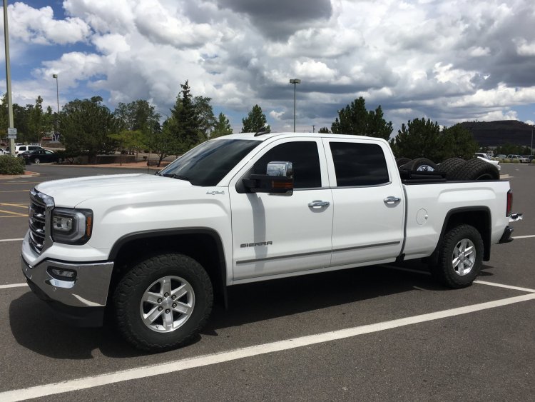

UrbanRage Posted August 31, 2018 Share Posted August 31, 2018 On 8/18/2018 at 9:49 AM, 2009GMC said: 285/70/17 bfg k02 5100 on 3rd setting for 1.5” front lift. Rear stock block. Still have 1 - 1.5” of rake which I like for hooking up trailer or small load in back. I have about 250 - 300 lbs of tires and bed cover in pic. Do you have any issues with the tires rubbing the upper control arm or fender well? Quote Link to comment Share on other sites More sharing options...
2018GMC Posted August 31, 2018 Share Posted August 31, 2018 Just now, UrbanRage said: Do you have any issues with the tires rubbing the upper control arm or fender well? No rubbing. Since my tuck is max tow I have steel upper and lower control arms. The 17" GMT900 wheels are at least an 1" narrower than stock K2XX wheels, offset may also be different. Quote Link to comment Share on other sites More sharing options...
