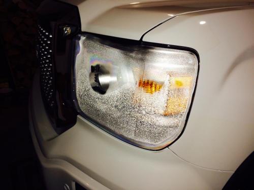

I woke up this morning to find my truck, '14 GMC K-1500 Sierra Denali in the garage with the left headlamp housing clouded up with condensation. No visible cracks, chips, scratches, etc., The right side lens remains clear....

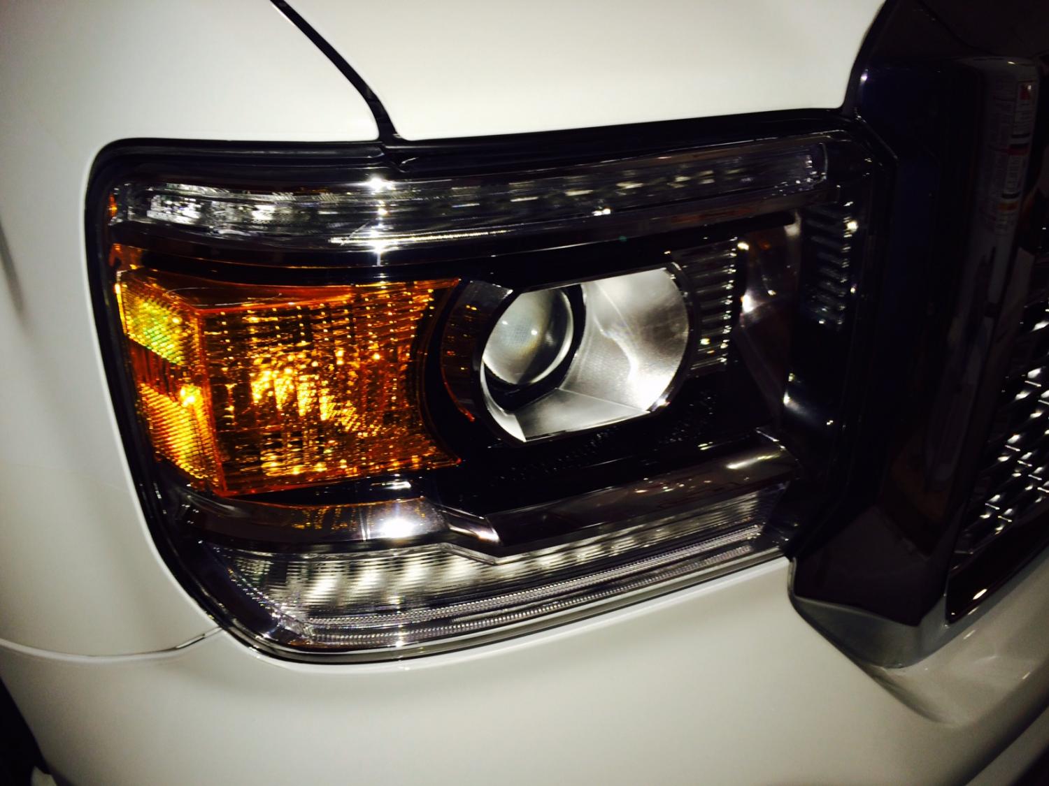

So I own a 14 sierra sle and seeing as though in northern IL it went from -5 to 40F in about a week all the ice melted and I had a bunch of dirt and grim on my truck.
I took it through the car wash and drove home. When I got home I noticed there was fog on the bottom part of my headlight.
I'm not sure if it's because the headlight is warm and the cool air is causing this fog in the headlight or if I have some type of leak or something in the headlight.
Anyone else have this problem?
Thanks
