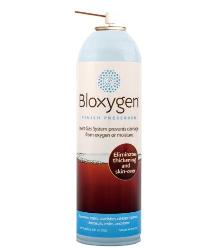

FYI: If you don't have access to nitrogen (or argon) gas, they sell it in spray cans for "wine preservation" purposes...
