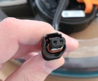

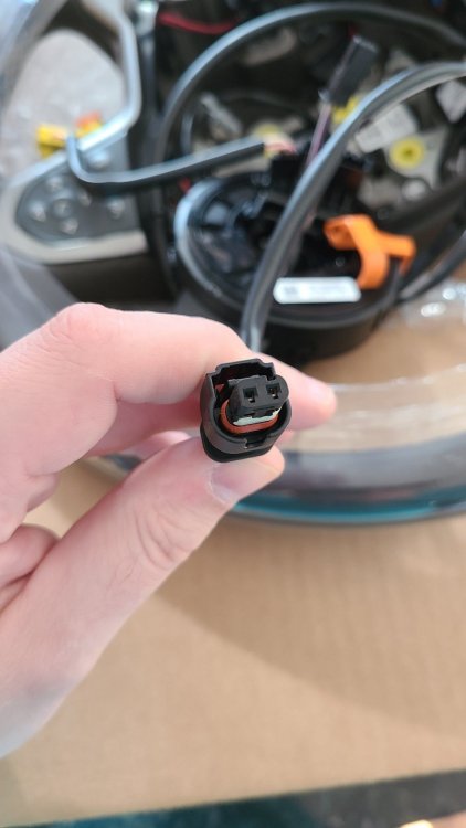

No programming required. Just make sure you have the (2) Connections for the clockspring below like in the the photos.
